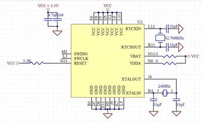

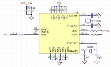

We are a third-party programmer manufacturer. Currently we are supporting the LPC54S018J4MET180E programming process and have the following problems
1. Use J-link test, can not program, only Read ID, as shown below
Our hardware circuit is as follows

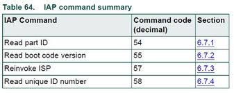

2.UM11155.pdf, LPC54018JxM/LPC54S018JxM User manual IAP command does not mention
Prepare sector(s) for write operation, Copy RAM to flash, Erase sector(s), Blank check sector(s), Compare command, as shown below
Is there a detailed process or step for programming Serial flash memory (0x10000000-0x103FFFFF) using SWD IAP?

As you know that the LPC54S018J4MET180E has on-chip 4MB(4M Bytes) serial flash, the flash name is Winbond W25Q32JV, as you know that the IAP functions such as Prepare sector(s) for write operation, Copy RAM to flash, Erase sector(s), Blank check sector(s), Compare command are only valid for on-chip parallel flash, they are NOT valid for serial spifi flash.

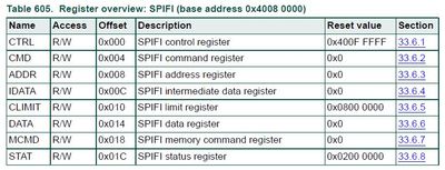

Now,I can't writed SPIFI register (0x4008 0000) used SWD
What could be causing it? or what needs to be set?
Please help with suggestions.

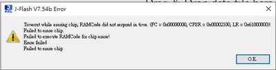

3.We can't program successfully using J-link, as shown in the figure below, do our hardware circuits need to be modified?
