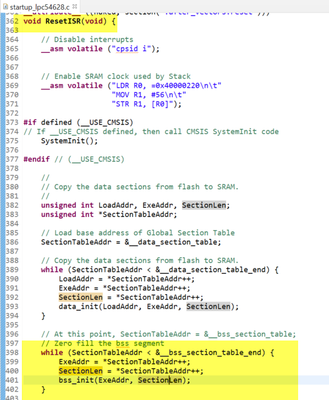

Hello giusloq,
Check your startup file, maybe fill zero with uninitalized data, for example MCXUpresso IDE:
Alice
3,088件の閲覧回数
giusloq
I  put a breakpoint at the beginning of ResetISR(), before initializing bss and data sections.
Even at this point, the variable that was initialized with a magic number before the reset appears again to zero.

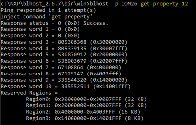

Hello giusloq,
Enter ISP mode, then use blhsot command "get-property 12":
The ROM reserved regions can be obtained from the blhost command "get-property 12".
Below picture is or lpc55xx:
Alice
