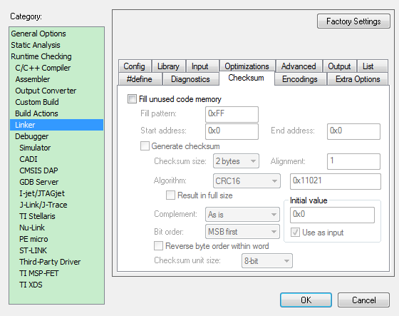

jeremyzhou
Hi Thomas Johansen,
1) How is the CRC for the boot block structure calculated?
-- You can the Checksum feature in the IDE to do that, for instance, IAR. I'd like to you can introduce what the exact goal you want to achieve, then I can focus on to implementing it.
Fig 1
IAR IELFTOOL Checksum - The basic actions
TIC
