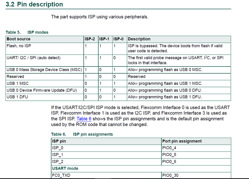

ISP pins configuration during  Reset state so taht you can enter bootloader mode:

dark0711
Thanks for the answer.
ISP is also blocked through eCRP. The controller is visible only through SWD
eCRP value set at 0x00019800 in vector table.

xiangjun_rong
Hi, Ahtoh,
If your ECRP data blocks both the SWD and ISP, I do not think there is any way to run the mass erasing command, in the case, you have to remove the old LPC54606 on board and populate a new one.
