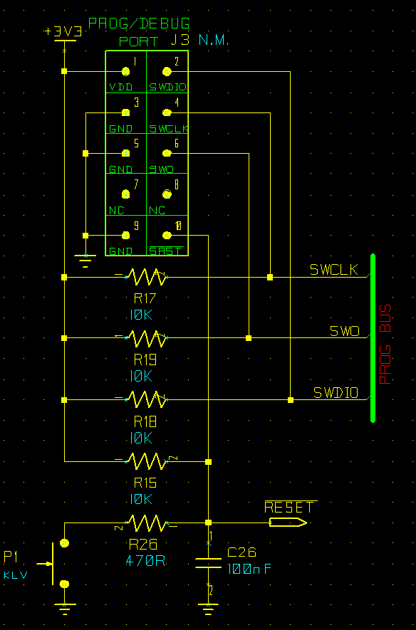

If the same image can work well on EVK board, while there is issue with custom board, I think
maybe it is the hardware board issue, please refer to SCH of EVK board to check.
Also check your SWD design refer to:
https://community.nxp.com/t5/LPCXpresso-IDE-FAQs/Design-Considerations-for-Debug/m-p/469565
Alice
3,410 Views
giusloq
If the same image can work well on EVK board, while there is issue with custom board, I think maybe it is the hardware board issue, please refer to SCH of EVK board to check.
My schematic is very similar to the one of EVB. Moreover, initially the board worked well and I was able to program and debug through SWD and J-Link. This means there aren't critical issues with my custom board.
The problem arised during development after some days. I don't know what happened, the last solution is that SWD port broke for some reason (ESD?), but only for the SWD functionality, because SWD pins work well when configured as GPIO.
Is this possible? The strange thing is that this happened two times for two completely different custom boards and two different MCUs from LPC546XX series.
 I checked it many times, there's no problem with that.

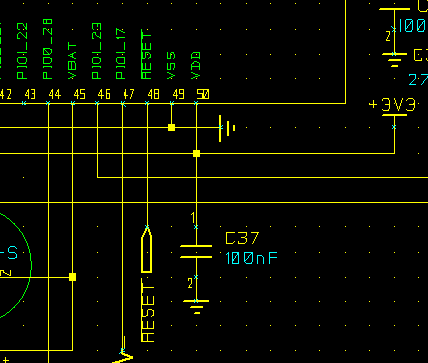

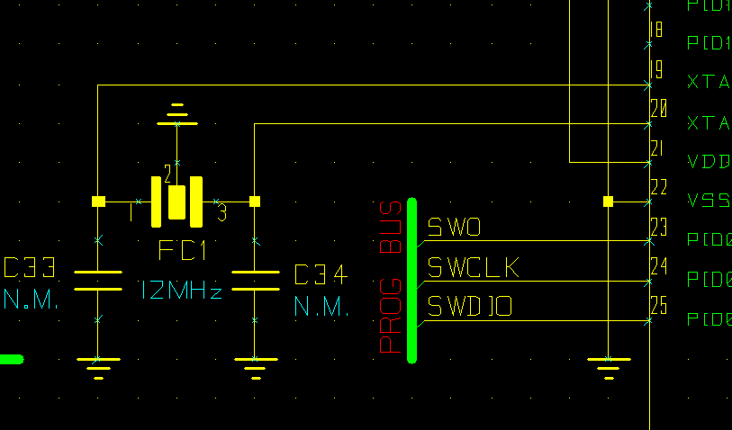

Here it is my schematic related to SWD.
