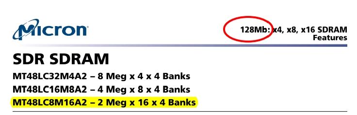

when I see the datasheet,LPC546XX Eval board sch has a mistake? Sch sheet 5 of 13 target EMC SDRAM .see the red part.0208_1_recompress.jpg

The schematic does indeed have an error with this 256Mb note, but the part number is correct. The memory size is 128Mb, as stated in the manual and on the board page on nxp.com.
We'll get the schematic corrected.

Do you mean the SDRAM size is wrong?
4,128 Views
shenxueyin
Yes.may be?
