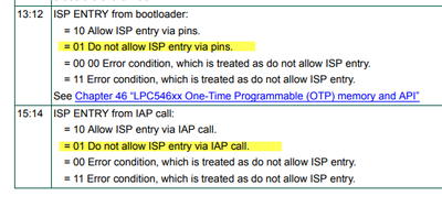

Hello @luimarma
"0x0001583B"
 have a "0" at bit  11, a "1" at bit 10
->> While the two descriptions not the same.
Also Pay attention, your configuration ""0x0001583B"" also do not allow enter ISP mode.
Alice

luimarma
Hello @Alice_Yang
About bits 13:12 and 15:14 I have it clear. We have an IAP routine to mass erase the LPC to be able to recover it for reflashing.
But still I dont understand why when we try to activate the IAP erase/wite protection at bits 11:10 then we cannot flash the image the first time. How can then bits 11:10 be programmed?

Hello @luimarma
Change ECRP value need erase the entire flash firstly.
If user can change ECRP value without erase full flash, this setting is meaningless.
Others can change ECRP to do not protect, then read out flash data.
So before change ECRP, must erase all flash.
Alice
