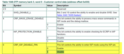

Hello Anders,
I think your solution is good, and also you can disable  enter ISP mode using the ISP pin through config
CRP_ISP_DISABLE_PIN in OTP,
while be careful: OPT is a non-volatile and write-once register. OTP is not FLASH and it can be ONLY written by IAP function. Once disable, we never can enter isp though ISP pins.
Just one suggestion, your solution is more safe than OTP.
Alice

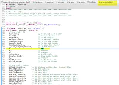

Hello Anders,
Add, OTP is dangerous to test, you can just config the flash ECRP, please see P1051 of UM10912:
directly config the data in startup_lpc54628.c file:
this configuration won't limited your chip.
Alice
