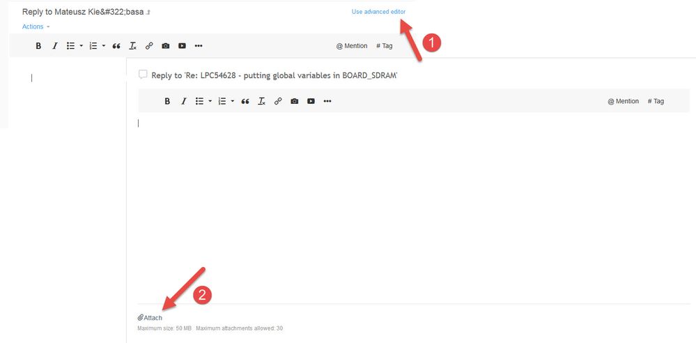

jeremyzhou
Thanks for your reply.
I think you'd better upload the project by following the below steps, as I fail to download the demo via https://community.nxp.com/external-link.jspa?url=https%3A%2F%2Fwww13.zippyshare.com%2Fv%2FoHNVAZyy%2...
Fig 1 Attach steps
TIC

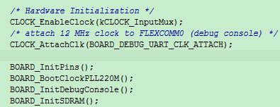

jeremyzhou
Hi Mateusz Kiełbasa
After having a brief review of the project, I'd like to point out that the below functions should be exected prior to jump to main(), otherwise, it will fail to put global variables in SDRAM.
Hope it helps.
TIC
9,895 Views
mateuszkiełbasa
I've put the code fragment inside `SystemInitHook` function and now when I type:
__DATA(BOARD_SDRAM) int hugeVar[10000] = {100};
the program runs fine and I can see the memory inside debug view. But I have a few questions :smileyhappy:
