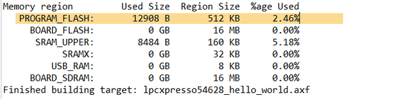

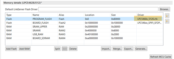

From your log I see that you are using the LPC54628 Hello world demo. However, are you using our evaluation board? and the hello world demo without any modifications?
If you do, please make sure to select the correct flash driver. Apparently you have selected the  LPC546xx_SPIFI_SFDP.cfx driver, which is for an external QSPI memory. Can not tell if this ok, or not. But the demo uses the on-chip program flash and the dedicated flash  driver for this on-chip flash.
diego_charles_0-1706722619508.pngdiego_charles_0-1706722619508.pngdiego_charles_1-1706722652152.pngdiego_charles_1-1706722652152.png
If the problem still appears, I recommed setting the MCU into ISP mode and do a mass erase. Let me know if you need more help on this.

Shashank3
Hi @diego_charles ,
I changed the driver to LPC5460x_512K.cfx and the example code works now, but won't it cause an issue as the device is LPC54628j512?
Shashank
2,560件の閲覧回数
diego_charles
Hi @Shashank3
No issues, that is perfectly fine. This LPC5460x_512K.cfx  flash driver comes as the default one for most of SDK examples. Also, LPC546xxx family is highly compatible.
