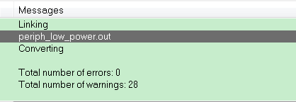

jeremyzhou
Hi ,
请参考附件内低功耗工程。
TIC

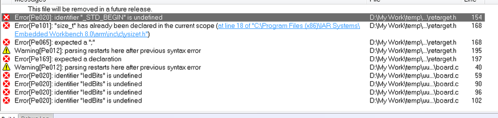

4,758件の閲覧回数
haifeng_jin
hi jeremy:
              thank you,but why the code have so many problems,do you know that? I do not know why such a simple power problem can be so long without result. Please work hard.
4,758件の閲覧回数
jeremyzhou
Hi ,
你确认一下Options>General Options>Target里,MCU是否正确。
我这边没有任何错误。
TIC
