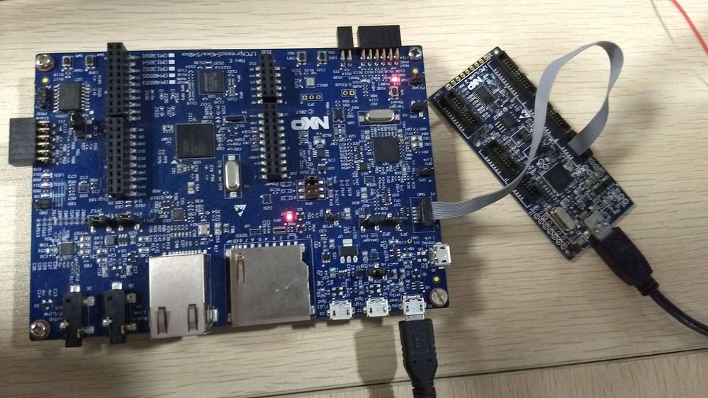

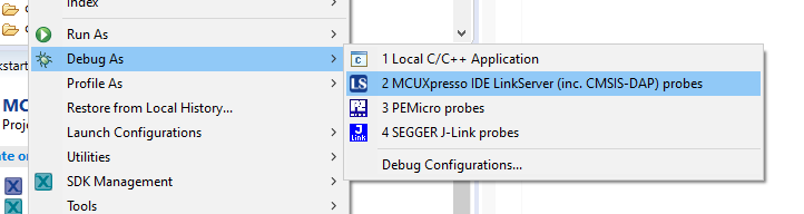

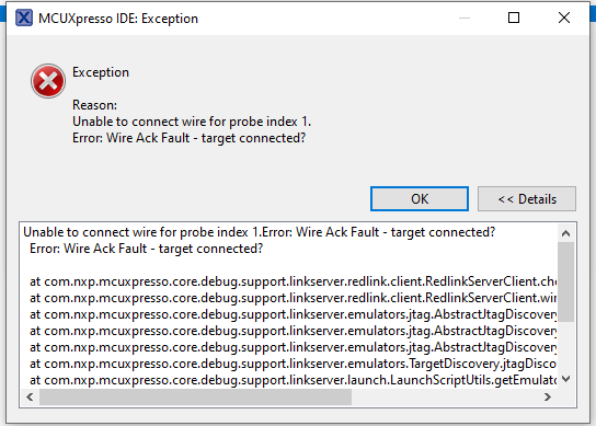

I am using LPC54628 kit. From debugging and programming image using LPC-Link debug probe.
In PC, I have installed MCUexpresso to connect with the board via LPC-Link.

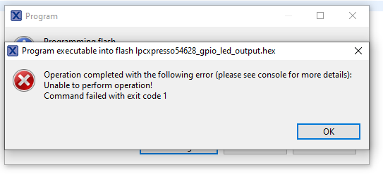

As a initial step tried "lpcxpresso54628_gpio_led_output" example to test but i couldn't able to flash to board. I can see below the error every time.

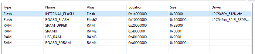

In GUI of flash image configuration as below
Anything missing in above to select?
Note: JP5 jumper is shunted . USB cable connected to J1 for power supply and LPC-Link debugger attached.
Does anyone have idea about how to resolve it?

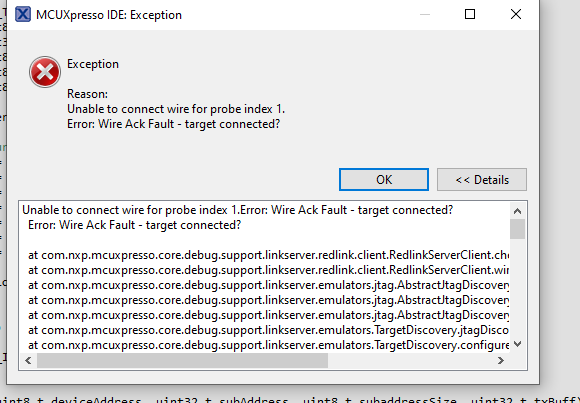

any solution for this problem?, i have the board IMXRT1050, in MCUXpresso 11.3, and the latest version of sdk

Thanks for your suggestion, I have tried all your points like updating LPC-Link2 debug firmware, new project and workspace, latest IDE (MCUXpresso IDE v11.1.1 [Build 3241] [2020-03-02]) and use of another computer but still no luck. See below setup

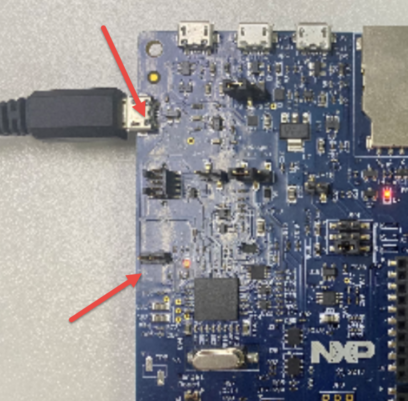

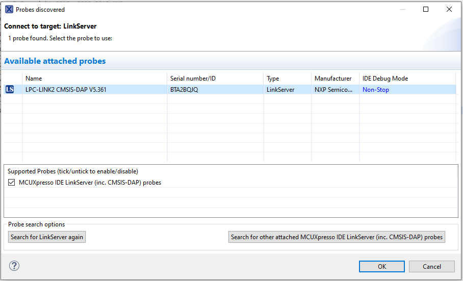

Could you please try on board debug interface? It's J8 on board.
if can't connect with J8, shunt DFU to update the on board firmware, if CMSIS can't connect, try Segger
10,266件の閲覧回数

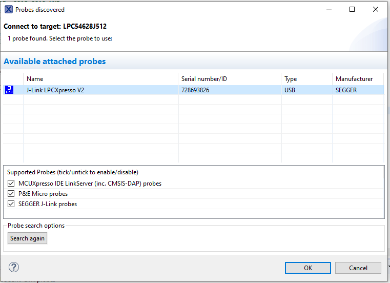

jbhoi
ZhangJennie‌
Thanks for your suggestions. First, I have tried by updating onboard firmware with CMSIS but using that still same error, see step by step process
then
then

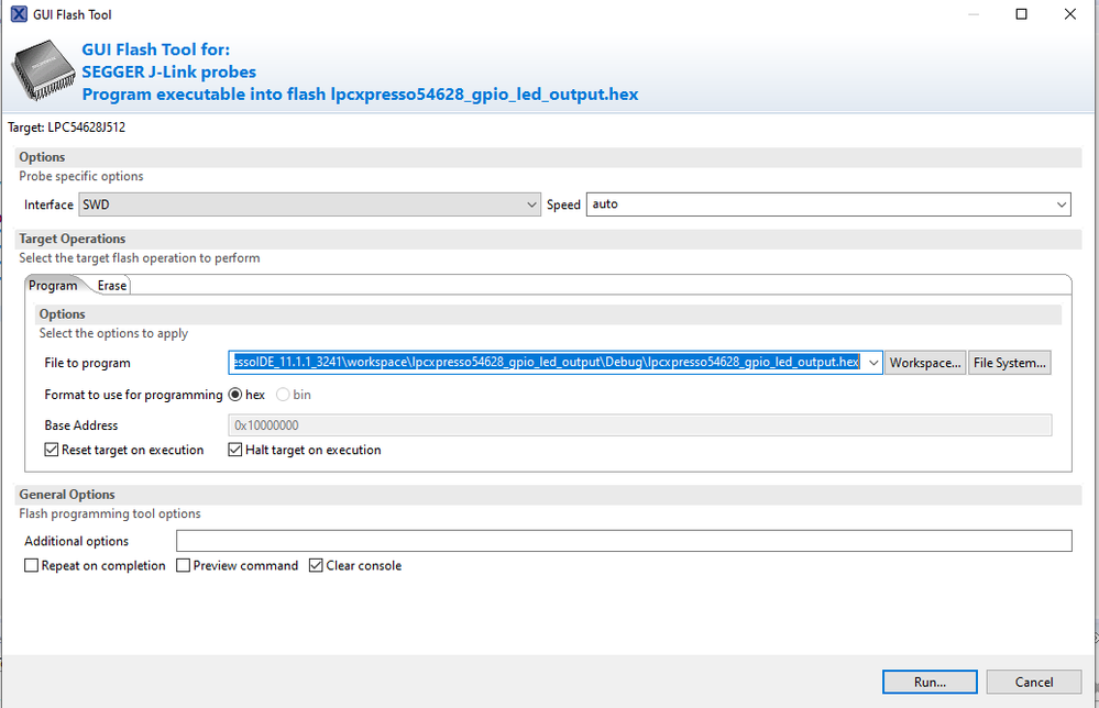

So i have tried by updating segger, see below the process
As console of MCUexpresso below prints come
Executing flash operation 'Program' (Program executable into flash lpcxpresso54628_gpio_led_output.hex) - Thu Jul 16 14:04:06 IST 2020
Checking MCU info...
Scanning for targets...
Executing flash action...
SEGGER J-Link Commander V6.80d (Compiled Jun 26 2020 17:17:12)
DLL version V6.80d, compiled Jun 26 2020 17:16:09
J-Link Command File read successfully.
Processing script file...
J-Link Commander will now exit on Error
J-Link connection not established yet but required for command.
Connecting to J-Link via USB...O.K.
Firmware: J-Link LPCXpresso V2 compiled Apr 4 2019 16:54:03
Hardware version: V1.00
S/N: 728693826
VTref=3.300V
Target connection not established yet but required for command.
Device "LPC54628J512" selected.
Connecting to target via SWD
Cannot connect to target.
Script processing completed.
Unable to perform operation!
Command failed with exit code 1

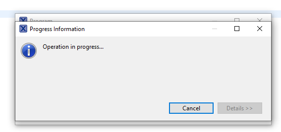

if select the JTAG in GUI Flash tool then it continues in a loop or stuck at below menu
Also, I have below configuration for flash

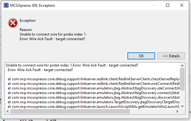

Unable to connect wire for probe index 1.
Error: Wire Ack Fault - target connected?
at com.nxp.mcuxpresso.core.debug.support.linkserver.redlink.client.RedlinkServerClient.checkServerReply(RedlinkServerClient.java:224)
at com.nxp.mcuxpresso.core.debug.support.linkserver.redlink.client.RedlinkServerClient.wireConnect(RedlinkServerClient.java:1192)
at com.nxp.mcuxpresso.core.debug.support.linkserver.emulators.jtag.AbstractJtagDiscovery.ideConnect(AbstractJtagDiscovery.java:232)
at com.nxp.mcuxpresso.core.debug.support.linkserver.emulators.jtag.AbstractJtagDiscovery.connect(AbstractJtagDiscovery.java:196)
at com.nxp.mcuxpresso.core.debug.support.linkserver.emulators.jtag.AbstractJtagDiscovery.discover(AbstractJtagDiscovery.java:155)
at com.nxp.mcuxpresso.core.debug.support.linkserver.emulators.TargetDiscovery.jtagDiscovery(TargetDiscovery.java:454)
at com.nxp.mcuxpresso.core.debug.support.linkserver.launch.LaunchScriptUtils.getEmulatorInfo(LaunchScriptUtils.java:257)
at com.nxp.mcuxpresso.core.debug.support.linkserver.launch.LaunchScriptUtils.init(LaunchScriptUtils.java:497)
at com.nxp.mcuxpresso.core.debug.support.linkserver.launch.LaunchScriptUtils.<init>(LaunchScriptUtils.java:165)
at com.nxp.mcuxpresso.core.debug.support.linkserver.launch.LaunchScriptUtils.<init>(LaunchScriptUtils.java:152)
at com.nxp.mcuxpresso.core.debug.support.linkserver.services.TargetDiscoveryService.getTargetDiscovery(TargetDiscoveryService.java:138)
at com.nxp.mcuxpresso.core.debug.support.linkserver.override.LSFinalLaunchSequence$TargetDiscoveryJob.run(LSFinalLaunchSequence.java:124)
at org.eclipse.core.internal.jobs.Worker.run(Worker.java:63)
We have design a Microcontroller board with LPC55S06-JHI48EL. I am using the latest IDE MCUXpresso IDE v11.5.1 and other latest software from NPX. I am using MCU link to program the board. The MUC link firmware is updated with the latest software. MCU link is connected to PC through USB cable, Other end of MCU link is connected to my pin through 10 pin flat cable .I am getting the following above error. Please suggest a solution.
