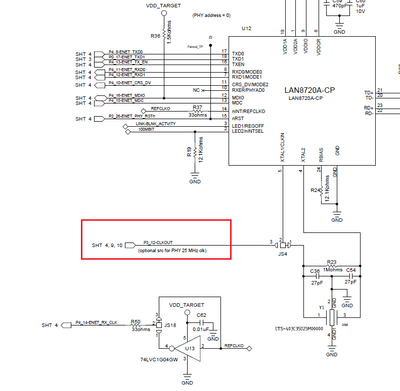

Hi! I'm trying to implement Ethernet communication between an LCP54618J512 and a LAN8720 module [https://www.ebay.com/itm/233331877929].
I previously tested with the LPCXpresso development board, which uses a 25 MHz XTAL, and everything works perfectly. I also tested with the LAN8720 module and an ESP32, overriding the 50 MHz clock output and generating the required 50 MHz signal in RMII mode using an ESP32 terminal.
Is it possible to use an LPC54618 terminal to generate the 50 MHz signal? The terminals I'm currently using are:
LAN8720
PHY (RMII)
LPC54618
TXD0
ENET_TXD0
PIO4_19 (14)
TXD1
ENET_TXD1
PIO4_20 (18)
TX_EN
ENET_TX_EN
PIO4_27 (85)
RXD0
ENET_RXD0
PIO4_23 (42)
RXD1
ENET_RXD1
PIO4_24 (67)
CRS_DV
ENET_RX_DV
PIO5_1 (126)
MDC
ENET_MDC
PIO5_3 (129)
MDIO
ENET_MDIO
PIO5_4 (135)
nINT/RETCLK
RMII_REF_CLK
PIO4_14 (194)
nRST
Reset PHY (optional)
PIO4_16 (203)
If I need to use the 50 MHz generated from the LAN8720 module clock, is there any sample code I can use?
Thanks'

Harry_Zhang
Hi @andrew_sig
I think yes, you are correct: the P3_12 pin (CLKOUT) can be configured to output a clock signal, and it can be used to provide a 50 MHz reference clock to the LAN8720 PHY for RMII operation.
Is there any sample code I can use?
Currently, there is no related sample code.
Harry

andrew_sig
Hi! Thanks for your response. I believe PIO3_12 can be used as indicated in the LPCXpresso 54608 user manual.
I'll try a code implementation using MCUXpresso Config Tool, and see what results it gives
