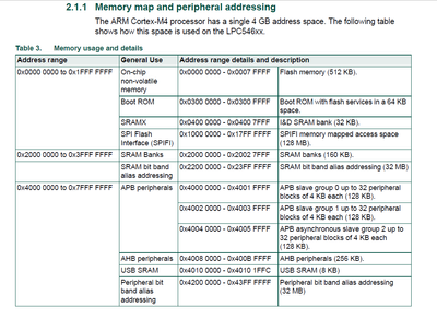

xiangjun_rong
As the following figure of LPC546xx memory map, the address 0x2000_xxxx are SRAM, for the error code:0x200058e0 <+0>: push {r4, r5, r6, r7, lr}, it appears that you allocate/execute the code in SRAM instead of Flash, while you allocate main stack in address 0x200044a8, as you see the code address(0x200058e0) and stack address(0x200044a8) are approaching, I guess that the code is overlapped with stack, that is why you get the hard-fault error, but it is only guess.
Pls try to allocate the application code in flash instead of SRAM or the other SRAM address and have a try.
XiangJun Rong
