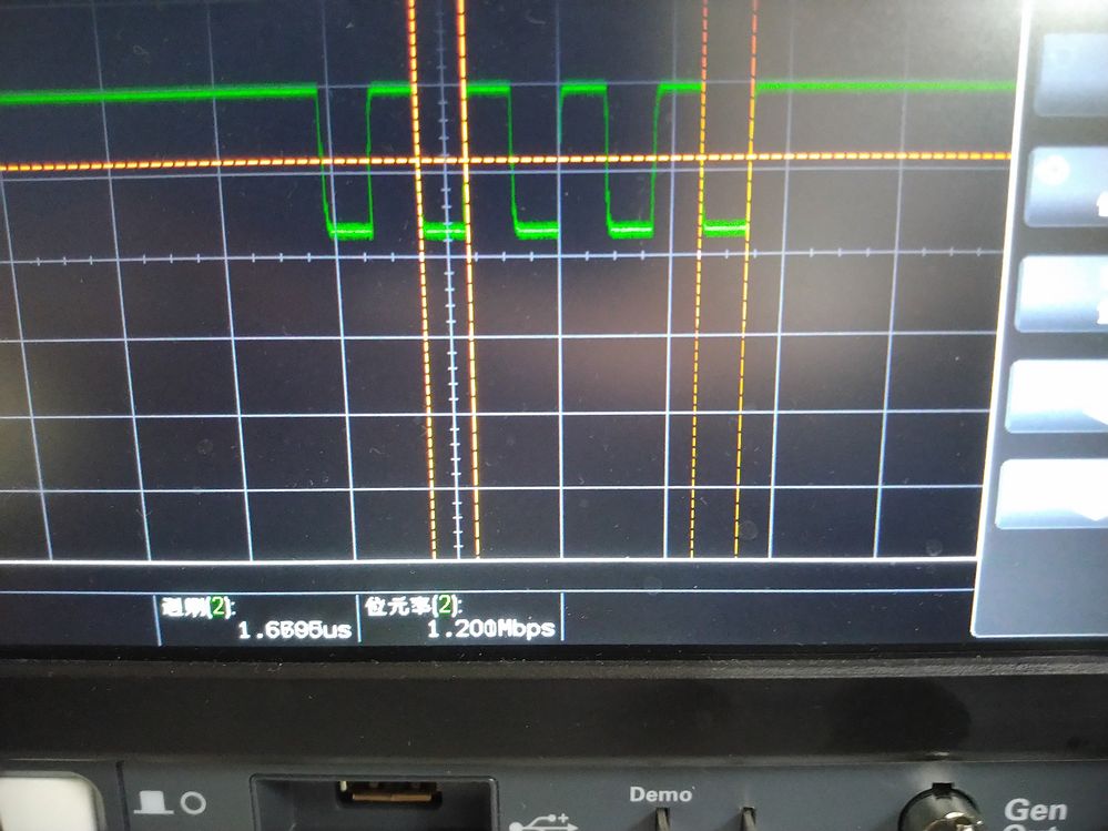

  Here I speed up the baud rate and verify by the oscilloscope.

When I speed up to 1.2Mbps, it works fine. But I raised up to 1.3Mbps, I see nothing in the oscilloscope.

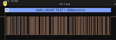

To verify that this works, I used the flexcomm2 interface with a baudrate of 1.5Mbps. I attached a 48Mhz clock to the interface.

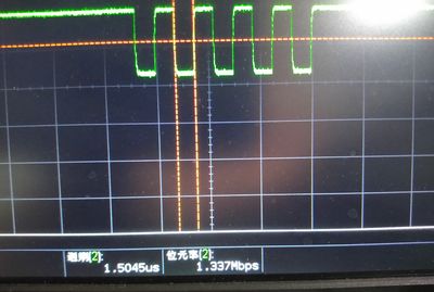

I use the 48Mhz clock source. Here is my code.
CLOCK_AttachClk(BOARD_DEBUG_UART_CLK_ATTACH);
RESET_PeripheralReset(BOARD_DEBUG_UART_RST);
result = DbgConsole_Init(BOARD_DEBUG_UART_INSTANCE, 5300000U, BOARD_DEBUG_UART_TYPE, 48000000U);
In the baudrate parameter, I use 5.3Mbps and it works at 1.33Mbps.(see attached picture)
I don't know why but it is not the most important.
It still can not up to 2.25Mbps. Can you try to speed up to 2.5Mbps by Flexcomm2??

I apologize for my late reply. I did some tests to check if these speeds are reachable. 5.3Mbps and 3Mbps were successful.
2.5Mbps was not possible because this baud rate is not supported. The OSR and BRG values can't reach that speed, if you set it to 2.4Mbps it will work as expected.
