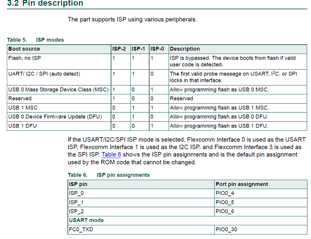

Could you please try the following https://community.nxp.com/thread/389112
For the LPC546xx, the pins are:
In addition please check the following link and let me know if this helps,
https://community.nxp.com/thread/487617
