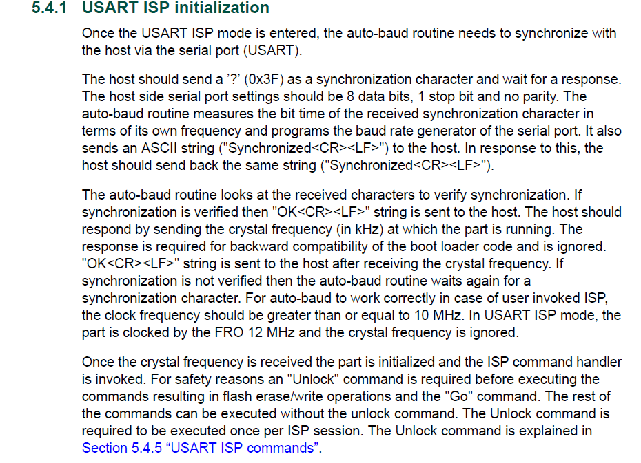

  1. Is this correct? is it changed from previous LPC devices?
    Yes, it is correct, it is using the plain binary format. Not the UU-encoded format which in the old LPC UART ISP.
  2. program the internal flash have problems.
   Because you do the write RAM and copy RAM to flash, do you do the UART ISP initialization at first?
Actually, we have an application note about how to process the UART ISP function:
https://www.nxp.com/docs/en/application-note/AN11229.pdf
Although it is not for LPC5460X, but you still can refer to it. Just note, the code format is plain binary format.
I recommend you can refer to the application note, also use the UART terminal to test it directly, instead of your own PC software.
If you still have problems, just give me the according terminal information, then I will check it and test it on my side.
