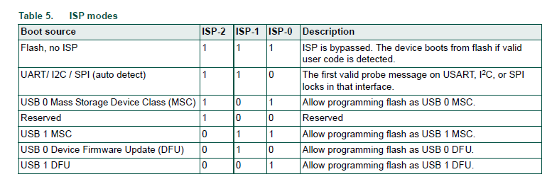

請教一下
有像
AN12384
LPC5460x UART Secondary Bootloader using YModem
文件一樣,將
1.UART接口改為USB接口使用 Bootloader
2.使用MCUXpresso IDE v11.0.1產生燒錄檔
是否有說明的文件,或範例可以參考
謝謝

I am afraid we don't have secondary bootloader for LPC546xx.
LPC546xx has on chip USB bootloader. for detail, see
Chapter 3: LPC546xx Boot process
This is the list of boot source:
Have a nice day

我只是想將USB CDC模擬UR收資料但無法收到ymodem所傳送的資料,所以想請教使否還需要修改哪些設定
謝謝

We don't have exact USB CDC secondary bootloader demo code.
But you can refer SDK USB CDC demo code to develop your secondary bootloader CDC driver .
usb cdc demo is included in MCUXpresso SDK package.
Welcome | MCUXpresso SDK Builder
