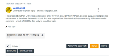

We are using an LPC5460x part with ECRP and a legacy boot image. We are finding that some of our parts, after setting the ECRP bits for release, can no longer be unlocked or mass erased. The parts are stuck with whatever firmware they had loaded on them and we can never update them. One or two parts are completely disabled, most like due to the section 2 of chapter 3.3.1 of the UM10912 manual.
What we don't understand is that most of the time things work just fine, we can flash a release image over a debug image, then revert to a debug image as needed.
The ECRP we are using:
bits set (0x00015800)
11 - IAP Sector Erase/Write protection is disabled.
12 - Do not allow ISP entry via pins
14 - Do not allow ISP entry via IAP call
16 - Disable external access to chip
No OTP registers are written by our code. Any suggestions on what we could be doing wrong here?

We would like to be able to mass erase and reprogram via SWD but prevent others from reading out the contents of ROM.
10,704 Views
While you have disable SWD
10,670 Views
corytodd
Hi Alice,
Yes, I realize that sounds silly. However, that's the only way we found to prevent reading out the ROM contents per table 1022.ECRP of UM10912 regarding SWD ENABLE.
"Internal memory contents can be read or compared."
Also, SEGGER's JCommand can unlock the part with SWD access "disabled" so there is more to the ECRP than we are understanding. Can you suggest an alternative?
We want to disallow SWD from reading ROM/RAM but allow mass erase. This has been simple on every other part we use but this LPC part does not seem to offer such an option that we can find. More problematically, the behavior is inconsistent.

corytodd
Hi Alice,
Yes, that's the method we use and it works about 80% of the time. That leaves us with 20% that we cannot unlock meaning the SWD appears to be permanently disabled.
Since some of these units have out bootloader on them we're able to load new application code. As a test we wrote a firmware that erases the ECRP vector to see if that would unlock the chip. Doing so does not restore SWD access. Additionally, we wrote a test firmware to issue a mass erase command which succeeded in wiping all the code but did not restore SWD access.
