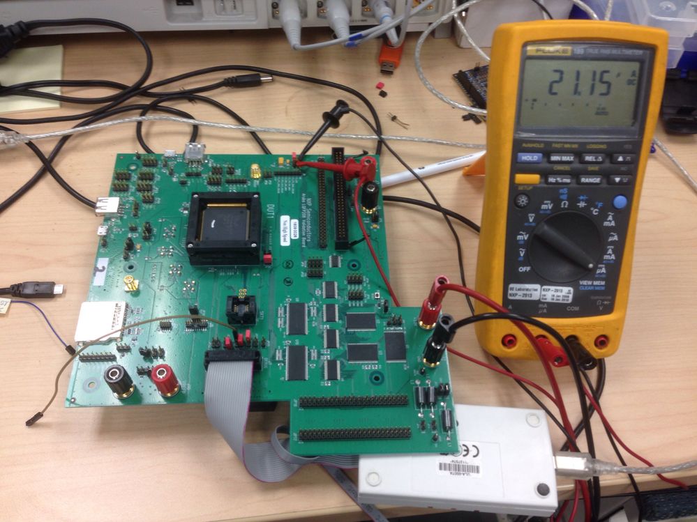

(the code I run is the exact same as Tom is running on the NXP ref design where he sees 21 uA)

Dezheng_Tang
There are several issues in your code.
(1) I suspect that your code got into exceptional interrupt handler before going to deep sleep mode since you shut off all the RAMs and no wakeup source to wake up the MCU from deep sleep mode. The current your got looks like active current to me or it went to deep sleep mode and came back on in 1 second and you didn't notice the current spike,
(2) If you want to use the UTICK as the wakeup souce, you will have to leave WDT on in deep sleep mode, then, your
deep sleep current would be higher.
First of all, make sure you go to deep sleep mode correctly:
        // Increase your UTICK interval from 1 second to 5 seconds, thus, give you enough time to monitor the power down
current.
        // Leave at least one RAM on, if your application use RAMX, then, you need to leave RAMX on, instead of RAM0.
        // Leave each RAM on in deep sleep mode, deep sleep current is ~5~10uA higher.
        Chip_POWER_EnterPowerMode( POWER_DEEP_SLEEP, (SYSCON_PDRUNCFG_PD_SRAM0 | SYSCON_PDRUNCFG_PD_WDT_OSC), 0 );
      // MCU should wake up after 5 seconds.
        while(1);      // Ideally, use the LED blinky code to make sure MCU wakes up by the UTICK.
(3) If you like to see lower current, use pin interrupt as wakeup source, you can power down the WDT in deep sleep mode as below. You will get the power number: closer to the data sheet:
  Chip_POWER_EnterPowerMode( POWER_DEEP_SLEEP, SYSCON_PDRUNCFG_PD_SRAM0, 0 );
(4) Once you program your code into the flash, make sure SWD_CLK is disconnected, or pull your SWD debugger out. It will lower your current.
(5) Little things makes difference. In your code, if you don't use GPIO or RAM2, or RAM3, don't leave them on, your actvie current will be lower.

Dezheng_Tang
Carsten,
    I got deep sleep current working on the 208-pin package socketed NXP validation board. I tested 3 chips on this board. There are some loose connection on the socket I struggled a lot, but once it's working, the overall the deep sleep current should match what our Datasheet states, 20~25uA.
Once you program the flash, if you have SWCLK tied to GND, the deep sleep current is around mid-70uA, take the jumper out to leave it open, it should be mid-20uA. I tried to tie VREFN to AGND or GND or both, it didn't make any difference. Attached here is my test code. But, for some reason, I suspect it's not your code but something is wrong on your board.
Tom

Dezheng_Tang
Carsten,
     You are very close, once you get to ~70uA, remove SWCLK jumper, it should get you down to mid-20uA. It's one of these pins (first ~30 pins you mentioned above) on your board causing the problem.
    Attached here is the 208-pin package schematics, it's not I don't want to show you the schematics in the first place, we also use this board for some analog characterization. So, it's not the simplest solution. The important part is this board doesn't have an on-board debugger tied to target, and all jumpers are very flexible.
JP1, JP2, JP7, JP23, JP24, JP25, JP27, JP29(3and4), JP31(3and4), JP57(1and2), JP70, JP71(1and 2), JP72, JP73 are closed, current is measured between JP21(1and2).
All these SJs are tied to the GPIOs, so, no EMC or SPIFI, or SD pins are connected.
All these GPIOs are inputs with pull-up already, you shouldn't have to do anything, if you set all GPIOs to output low, the total I/O current should show little difference.
Once you program the deep sleep code to the flash, remove jumper on JP31, you should save additional 40~50uA.

Thanks Tom,
I have looked over the schematics, and at first glance I don't see anything (much) different than I do :smileysad:
But, can you also measure the current for USB1, analog etc ? When I measure the consumption, I do it for my board in total (total current on 3.3V). I need the total current for the complete chip in order to be able to judge if we can use it or not.
Don't misunderstand me, I appreciate the schematics and the work you have done in explaining it, but it would still be nice if someone from NXP would take the responsibility and make a simple and correct schematic for the verification of the deepsleep current (I'm not knocking on you in any way! :smileywink:). As I wrote, I will get a test board produced ASAP if such info could be made available from NXP.
I have also issued a support ticket about this as time is running out and we do soon need to make a decision here...
30,960 Views
Dezheng_Tang
Carsten,
    Someone internally is working on a simplified board to measurement deep sleep current. Once he finished the testing,
I will ask around if we could loan you a board to do some measurement.
    For deep sleep current with USB1, this is a tricky one: you have two options to do that:
(1) If you want to use USB1Wake or USB1Activity interrupt as the wake up source to wake up the part from deep sleep, you will have to leave USB PLL, external OSC, USB PHY, and USB RAM on in deep sleep mode, it will result lot higher deep sleep current. We have the option to do it, but personally speaking, it's not desired.
(2) You can use the pin interrupt to wakup MCU from deep sleep, then, you can pretty much shut off everything when you call Chip_POWER_EnterPowerMode(), the deep sleep current should be the same as I mentioned earlier, lower-to mid 20uA, you can have the USB1 running in normal operation, but, you need to shut off all the USB1 related: USB PLL, external OSC, USB PHY, USB RAM, route USB1 VBUS pin to a GPIO pin interrupt, before going to deep sleep mode. After wakeup (e.g. USB cable is plugged in and connected to the host, VBUS is high), you need to power up external OSC and USB PHY, re-enable USB PLL, re-initialize USB1 controller, etc., which result longer wakeup time. But, deep sleep current is very low.
Tom
