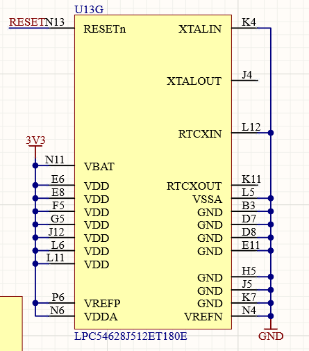

I do not use XTAL. I use the internal clock.

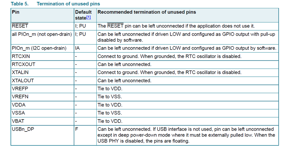

If I don't use external XTAL, Should I connect the K4 pin to GND and open the J4 pin?
1,182 Views
carstengroen
Senior Contributor II
According to the datasheet, yes (don't mind the typo at the "XTALIN" pin where they write "the RTC oscillator is disabled" :smileyhappy:
(I also do this in all my designs, works perfectly)
One of my designs:
