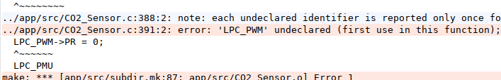

trying to compile a project that sets the PWM timer function but symbol is not defined.
It seems that in chip_lpc175x_6x.h there is a LPC_PWM1_BASE is defined address but I cant' find any PWM structure despite it being listed in the LPC17xx user manual. All of the members of the LPC_PWM seem to be set are that of the PCLK_PWM1 but this is not defined either. All I can find searching the header files in lpc_chip_175x_6x Project is the PWM1 base address, MCPWM base address, and something worrying commented FIXME: PWM  drivers.!

FIXED. Posted for documentation.
I have had a chance to have another look around.
I have used the latest lpc_open libs.
The version of the lpc open in the project I have is an older version of hte lpc open includes which has the LPC_PWM defined via the route below.
in
chip_lpc175x_6x.h
#define LPC_PWM1_BASE             0x40018000
and
#define LPC_PWM ((LPC_PWM_T *) LPC_PWM1_BASE)
and in
pwm_17xx_40xx.h there is the definition of LPC_PWM_T
but in the latest version of  chip_lpc175x_6x.h where in the old version (line 186)
#include "pwm_17xx_40xx.h"
we have instead
/* FIXME : PWM drivers */
So I stated a new work space and rather using the latest lpc_open download made sure  imported the old version in the project.

thomasbrickell
Hi , thanks for the response,
It's not a demo project it's a project I have inherited from a another developer. It was initially developed on lpcxpresso from my understanding but I have moved it to mcuxpresso.
I am of course making the assumption here that the
#1. The project I have is complete as I have been assured and that LPC_PWM was not defined from the base address and the strut defined by the previous programmer.
#2. Because of #1 that the definition of LPC_PWM structure is supplid in the lpc open header files.
I have made this assumption because I have seen reference to the structure here.
And in other places. (Note I have tried the LPC_PWM1 as in example.)
