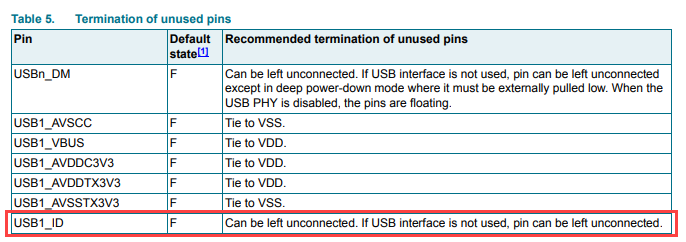

When not using USB1\ID(G1) pin , can I connect USB1\ID(G1) pin nowhere?

Please refer table 5 of the data sheet.
Hope it helps!
Victor.
