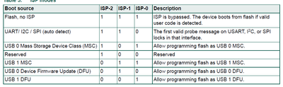

LPC540xx can support SPIFI boot ( Boot from QSPI NOR flash device connected to SPIFI interface. ), but LPC54608 doesn't support.
The available boot source for LPC546xx is as below:
User needs to access SPIFI device from internal Flash.
