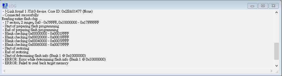

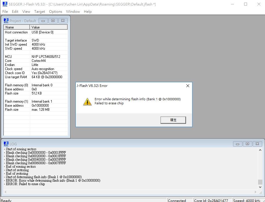

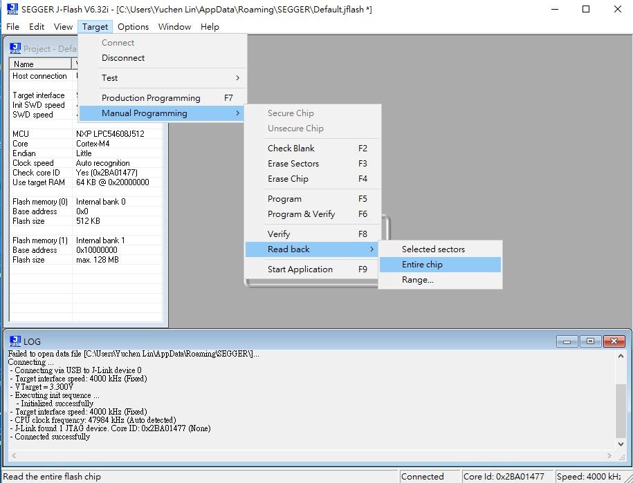

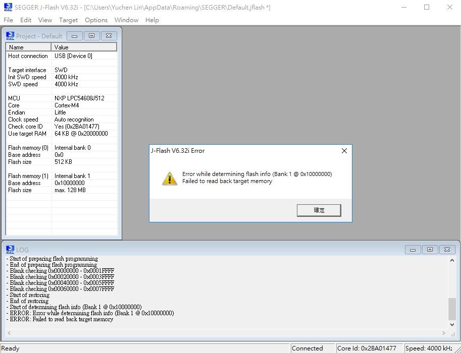

Hi Sir,
I used the J-link SWD interface to connect to our board and successfully read the SWD device ID.
But Read Back Entire Chip will have the following error message,Erase also has the same error message.

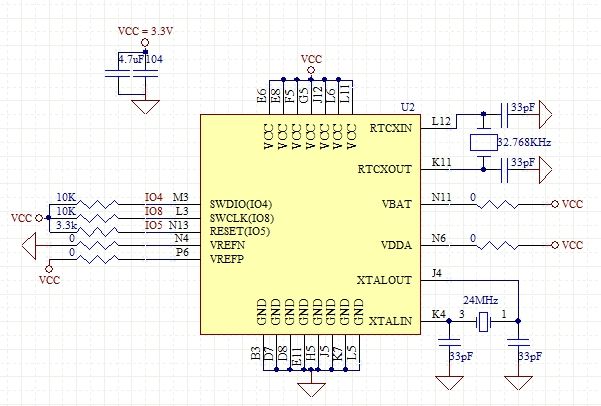

Our hardware circuit is as follows
Please help to confirm if the hardware need to be modified.
Thank you
Gary
2,207 Views
jeremyzhou
Hi Gary Yang,
After having a brief review of the schematic, I don't find something wrong with it, so whether you can introduce the complete steps to replicate the phenomenon.

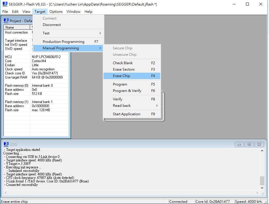

Hi Sir,
My tested steps are as follows
step1. Select device NXP LPC54608J512
step2. Target-->Connect, successfully read the SWD ID
step3. Target-->Manual Programming-->Read Back-->Entire chip
Repeat step1 and step2
step4. Target-->Manual Programming-->Erase Chip
Please help with suggestions
Thank you
Gary

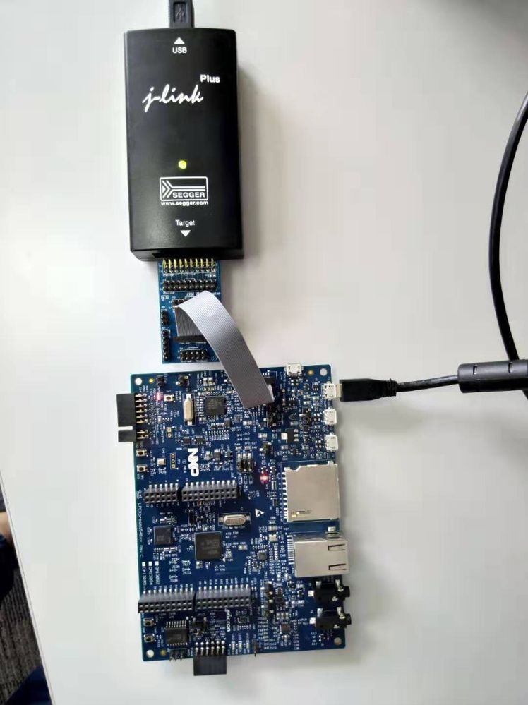

jeremyzhou
Hi Gary Yang,
Thanks for your reply.

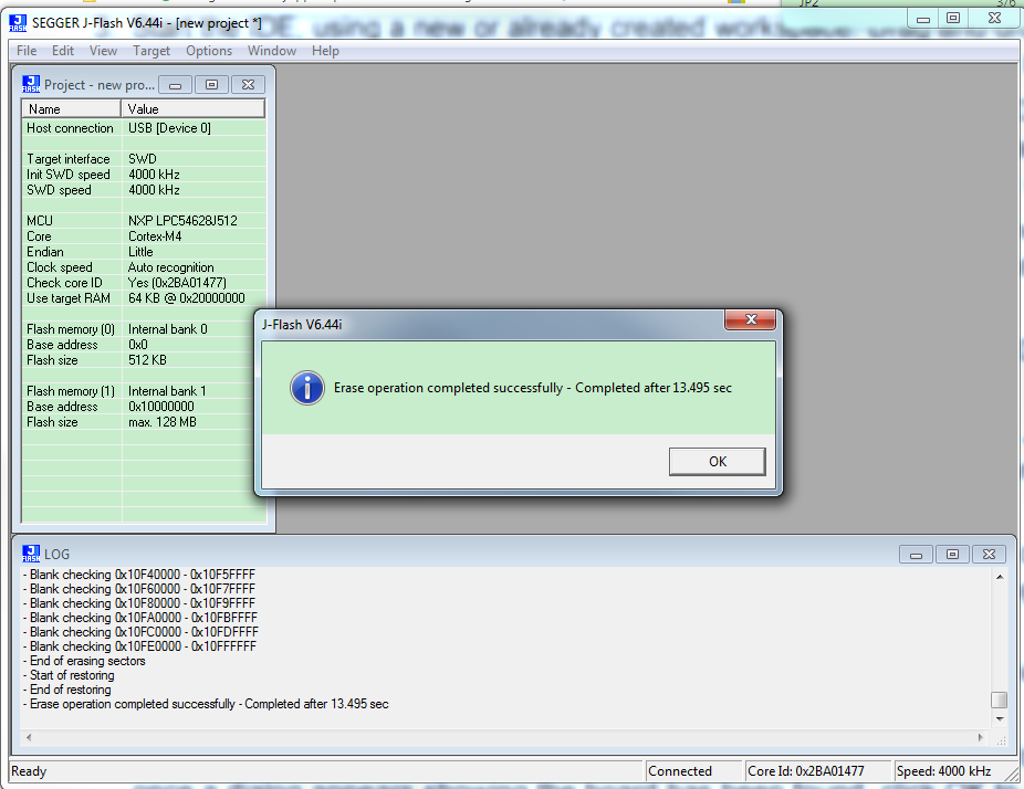

I'd like to follow the steps to replicate the phenomenon, however, on my site, it works well actually.
Fig 1 LPC54628 board

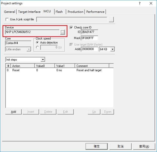

Fig2 Project setting
Fig3 Chip Erase
TIC

bernhardfink
Are you sure that you have a flash connected to the interface which addresses 0x10000000?
This is the memory area of the QSPI flash, connected to the SPIFI.
And the second point is:  does J-Flash know how to deal with this QSPI flash? Is there maybe something to set in the Flash tab of the project settings?
Bernhard.
