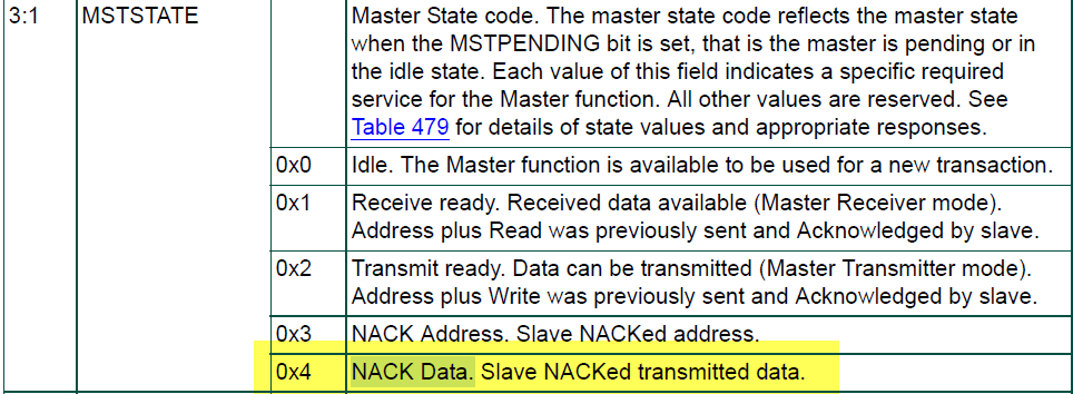

Hi all,
We are using LPC54608 mcu. In this we tried i2c based eeprom device read and write.
Data write we followed:
void data_write(uint8_t Byte_address, uint8_t value){
I2C_MasterStart(((I2C_Type *)(I2C2_BASE)), 0x50U, kI2C_Write);
I2C_MasterWriteBlocking(((I2C_Type *)(I2C2_BASE)), &Byte_address, 1, kI2C_TransferNoStopFlag);
I2C_MasterWriteBlocking(((I2C_Type *)(I2C2_BASE)), &value, 1, 0);
I2C_MasterStop(((I2C_Type *)(I2C2_BASE)));
//delay();
Inside this I2C_MasterWriteBlocking function there is one more function called
status = I2C_PendingStatusWait(base);
first time (Byte_address)I2C_MasterWriteBlocking we received status = 0x805 but second time during value write this status value becomes 0x809 so it skipped without writing data into base->MSTDAT register.
Where i missed?
how to solve this.
Thanks in advance.

prathap_ponnuch
Hi Alice,
Problem solved its pinmux configuration issue.
Thanks for your support.
prathap

Hello prathap ponnuchamy,
0x809 meaning   NACK Data. Slave NACKed transmitted data.
so please check whether address and sub address is right? Also check I2C slave work well?
Alice
