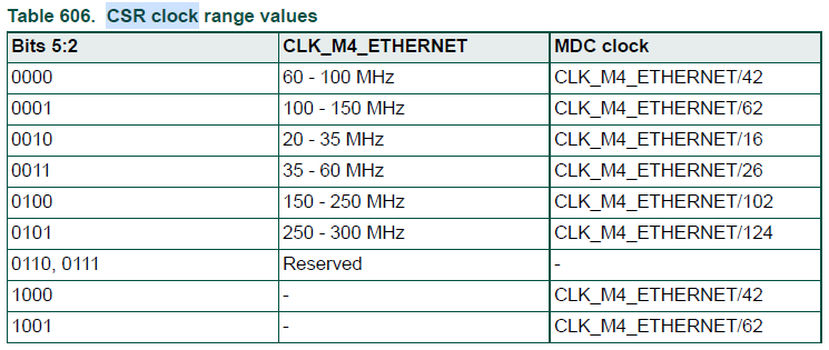

I am using the LPC54608 evaluation board OM13092 and want to get Ethernet running using a system core clock of 180 MHz. The examples of the SDK2.2 use only 48 MHz system core clock.
In the MAC_MDIO_ADDR register I have to select a CSR clock range (Bits 11:8). According to the user manual Rev2.0, I can set CSR values for clock ranges up to 150 MHz. How can I set a clock range for 180 MHz?
Holger
(Source: NXP UM10912 User Manual Rev. 2.0, Table 800)
P.S. The OM13092 uses a LAN8720 phy, which allows for a maximum MDC clock period of 400ns -> 2.5 MHz. If I would use the register value 1, I would get a clock of 180MHz / 62 = 2.9 MHz. Therefore I need the possibility to get a lower MDIO clock.

hlsamts
In the meantime I found out, that it is possible to use the value 0x4, which divides the core clock by 102. I found this value in the LPC43xx users manual (Rev 2.0, Table 606) and just gave it a try.
However:
Could anyone from NXP please give an official statement confirmation?
Please enahce your users manual with the next update.

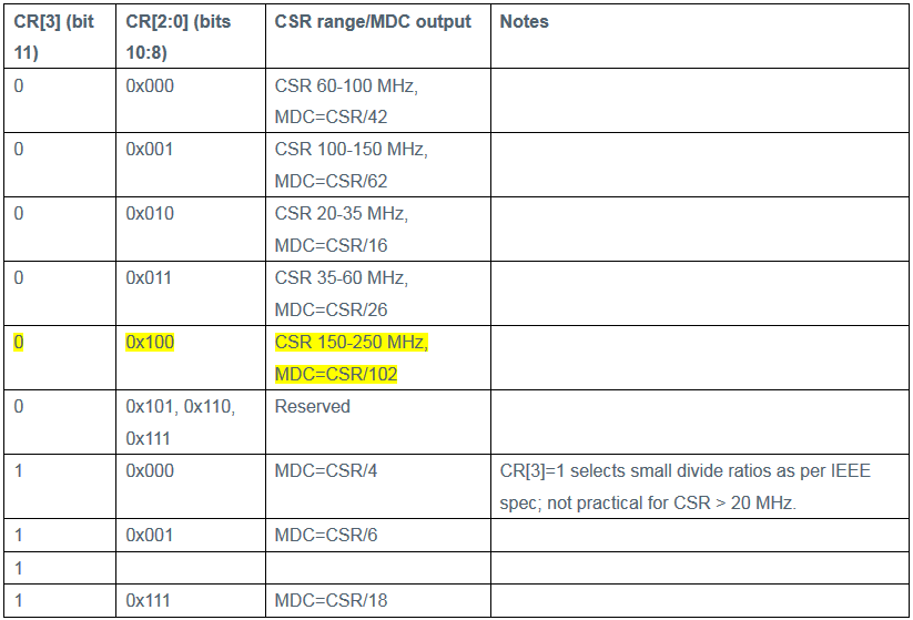

jeremyzhou
Hi Holger Sachs,
The below is the reply from the AE team, please check it.
Below is summary of the full CSR clock range table. The UM is incomplete and will be updated in next revision. This update will be also applied to LPC54(S)0xx series.

jeremyzhou
Hi Holger Sachs,
We both consider it should follow the same range rule as the below table shows, however, we need to contact the IP RD team for confirming.
