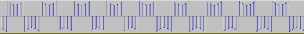

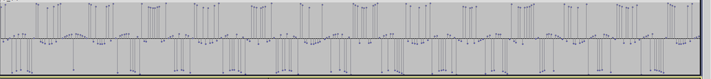

kalesha
As per your suggestion we used TDM mode we got the output and we are storing TDM voice data into the Flash storage through microcontroller.
After writing Voice data into the flash storage we are reading data from the flash and directing to the codec using TDM mode through microcontroller and we are getting same voice which was stored in flash during recording.
We are reading the voice data from the flash and writing the data into a file (text file in a pen drive) connected to microcontroller through usb host, after data writing completed when we are playing the the voice data  from the file we are  getting noise .
As per our observation we are sending the correct data from the flash to the file but when we were playing the file  through audacity (raw data player)  software in pc we are not using TDM mode .
please provide the clarifications needed for the below points
1)How can we get rid of getting noise from a file which was placed in a pendrive.
2)Do we need the use the TDM mode for paying the raw data in PC.
3) If we need to use the TDM mode how can we use in  audacity or any raw data player.
Please go through waveform pic of the raw data attached to this query.

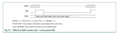

xiangjun_rong
If you use TDM mode, I suggest you select mode 3.
You have to configure the P1CFG1,P1CFG2 registers.
Assume that you have 4 slots, 2 pairs, each slot has 32 bits, the frame length is 32*4=128
In the case, P1CFG1=0x01; P1CFG2=64<<16;
Pls have a try
