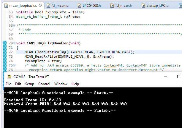

First I recommend you to download the new version (2.4.1) of the SDK, since a lot of improvements and bug fixes were made in this new version.
I modified the example mcan_loopback of the SDK (2.4.1) in order to work with CAN1 instead of CAN0. Here are the modifications I made to the example.
First, I modified some defines:
#define EXAMPLE_MCAN_IRQHandler CAN1_IRQ0_IRQHandler
#define EXAMPLE_MCAN_IRQn CAN1_IRQ0_IRQn
#define EXAMPLE_MCAN CAN1
#define MCAN_CLK_FREQ CLOCK_GetFreq(kCLOCK_MCAN1)
In the main I modified the functions that enable the interrupt (lines 157 and 158):
/* Enable RX fifo0 new message interrupt using interrupt line 0. */
MCAN_EnableInterrupts(EXAMPLE_MCAN, 0, (CAN_IE_RF1NE_MASK >> CAN_IE_RF1NE_SHIFT));
EnableIRQ(CAN1_IRQ0_IRQn);‍‍‍
After I modified the handler:
void CAN1_IRQ0_IRQHandler(void)
    MCAN_ClearStzatusFlag(EXAMPLE_MCAN, (CAN_IE_RF1NE_MASK >> CAN_IE_RF1NE_SHIFT));
    MCAN_ReadRxFifo(EXAMPLE_MCAN, 0, &rxFrame);
    rxComplete = true;

You mentioned that you are using PIO1_17 and PIO1_18, be sure that you are selecting the correct function for these pins. According to the user manual you should select function 5 for both pins.
Hope it helps!
Victor.

in your image there is written " MCAN_ClearStatusFlag(MCAN_EXAMPLE,  CAN_IR_RF1N_MASK); " at line 72 but you modified it in text as
I tried both, nothing changed.
