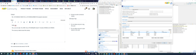

Hello vijo,
Yes, you are right, the 256K chip LPC54606j256 doesn't includes SRAM2 and SRAM3.
The memory detail should like below:
Alice
7,429 Views
vijo
hello Alice,
great, thank you for the info.
Could this be expressed a bit more visible please in the data sheet or the manual. You screen dump is from the MCUXpresso.
Viggo
