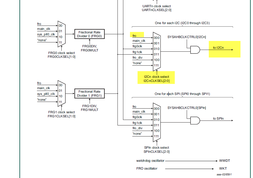

    #define I2C_MASTER_CLOCK_FREQUENCY (12000000) is the I2C module clock source frequent, not the core clock.
  Please check this information:
So, you need to check SYSCON I2CnCLKSEL, which clock you are choose, you can debug your code and check it.
 If you are choosing the FRO, it is 12Mhz.
But if you are choosing main_clk, and your main_clk is 30Mhz, then I am afraid it is your code problem.

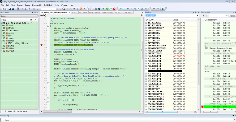

thanks for your advise. Unfortunately I don't have the MMA8652 break-out board and can just load the example and debug the LPC845. I assume that initialization of the master (LPC845) is completely done before starting communication with the MMA8652 break-out board. So I upload the example to the LPC845 and hit F8. This will lead to line 524 in fsl_i2c.h, which is right after the function init_i2c_master() in main.
When I then look at FCLKSEL5 (0x4004 80A4) I see 0x7, which is the reset value and means 'none'. So no clock is selected for I2C0? And I can't identify any clock configuration in main after that point.
And as I stated above, in mex-file 30 MHz is selected. So having 12 MHz as peripheral clock for I2C0 is a little bit difficult from my point of view (at the moment, and that is my problem).

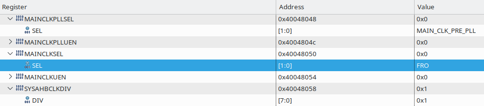

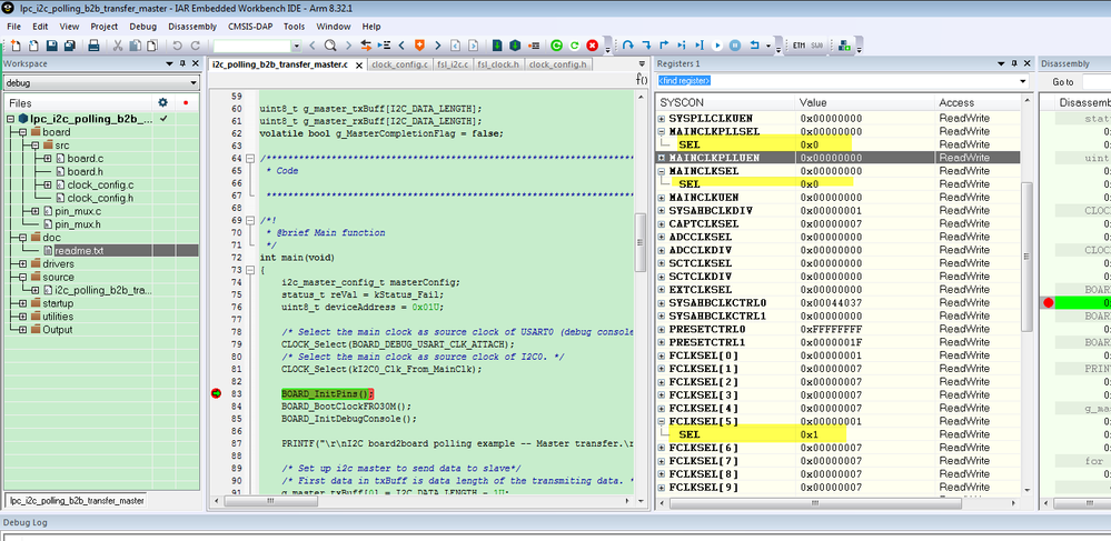

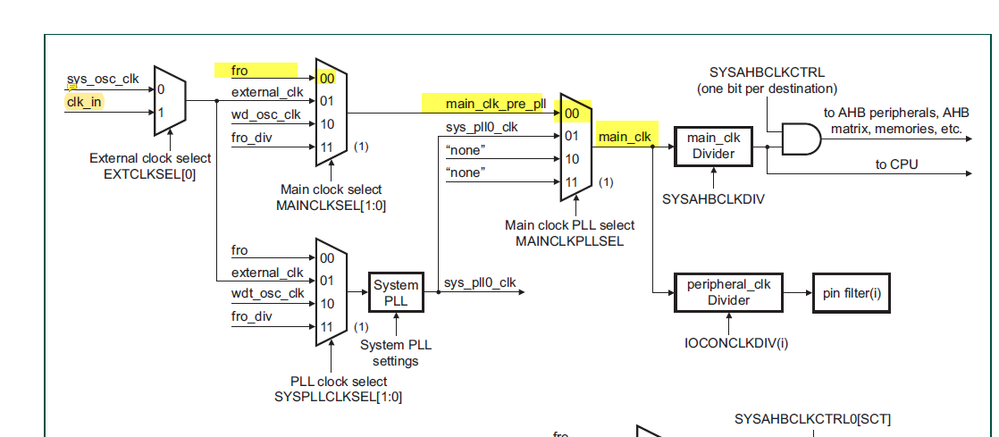

1234567890
Hi, thanks for your reply.The example I mean is from an official NXP site as I wrote above.
I checked your example. One of the differences is, that
/* Select the main clock as source clock of I2C0. */
CLOCK_Select(kI2C0_Clk_From_MainClk);
is called in the code. So here the clock source is chosen.
So I think the example code from LPC845-BRK is wrong.
But o.k., let's continue with your example: The next line in your debugger screenshot above is
BOARD_BootClockFRO30M();
which is
void BOARD_BootClockFRO30M(void)
    /*!< Set up the clock sources */
    /*!< Set up FRO */
    POWER_DisablePD(kPDRUNCFG_PD_FRO_OUT);      /*!< Ensure FRO is on  */
    POWER_DisablePD(kPDRUNCFG_PD_FRO);          /*!< Ensure FRO is on  */
    CLOCK_SetFroOscFreq(kCLOCK_FroOscOut30M);   /*!< Set up FRO freq */
    CLOCK_SetFroOutClkSrc(kCLOCK_FroSrcFroOsc); /*!< Set FRO clock source */
    POWER_DisablePD(kPDRUNCFG_PD_SYSOSC);       /*!< Ensure Main osc is on */
    CLOCK_InitSysOsc(12000000U);                /*!< Set main osc freq */
    CLOCK_SetMainClkSrc(kCLOCK_MainClkSrcFro);  /*!< select fro for main clock */
    CLOCK_SetCoreSysClkDiv(1U);
    /*!< Set SystemCoreClock variable. */
    SystemCoreClock = BOARD_BOOTCLOCKFRO30M_CORE_CLOCK;
Here the system oscillator is configured to 12 MHz. I don't know what it is good for, but doesn't matter here.
The FRO is configured to 30 MHz and chosen as main clock source. Even SystemCoreClock is updated to 30 MHz. So from my point of view the result of all is: I2C0 clock is 30 MHz, not 12 MHz.
Sorry, please show me where I went off the track.
EDIT/ADDED: I loaded your example without slave attached and let the program run to line 101 in main (i2c_polling_b2b_transfer_master.c). I think the master should be completely configured because the next line starts communication with the slave.pastedImage_2.pngSo for me it looks like I stated above: I2C0 runs from FRO, previously configured for 30 MHz. Because of I2C0->DIV (DIVVAL = 9, means divided by 10) the effective clock for I2C is 3 MHz.

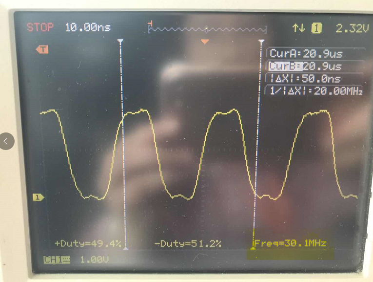

   You are right, after the detail checking, the SDK have bugs about the I2C code.

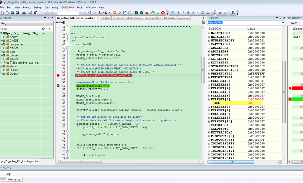

  I have tested the main clock, it is really 30Mhz, I output the main clock to PIO0_6, with the following code:
1.  pin mux.c
 Add:
       // CLKOUT to P0_6  kSWM_CLKOUT kerry add
    SWM_SetMovablePinSelect(SWM0, kSWM_CLKOUT, kSWM_PortPin_P0_6);
Above  CLOCK_DisableClock(kCLOCK_Swm); in void BOARD_InitPins(void).
2.  in main code:
   //========clkout P0_6 choose main clock
    SYSCON->CLKOUTSEL = 1;
    SYSCON->CLKOUTDIV = 1;
Then we can find the main clock in the PIO0_6, it is :

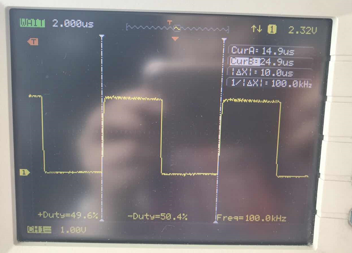

So,  please modify the I2C master clock to 30Mhz, instead of 12Mhz.
#define I2C_MASTER_CLOCK_FREQUENCY (30000000)//(12000000)
I will report this bug to our according department.
Then when you test the I2C, you will find the I2C clock is 100Khz.
Thanks a lot for your question post, it is really very useful to our SDK improvement.
  Wish it helps you!
Kerry

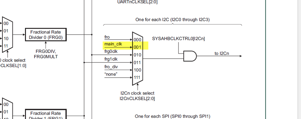

   About the FCLKSEL5 (0x4004 80A4)=0x7, because you didn't call the code to select the I2C module clock:
  Actually, the SDK code already have it, when you write your own code, you need to add the module clock selection at first.
