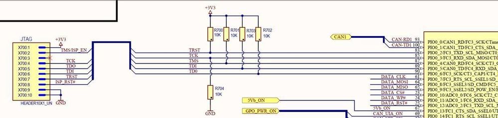

Please consult an LPC54606 JTAG circuit design problem design JTAG mode according to the pin definition in the manual, the chip device cannot be detected

Cortex-M4 parts do not use JTAG for debug. They are SWD only.
JTAG is for boundary scan only.
