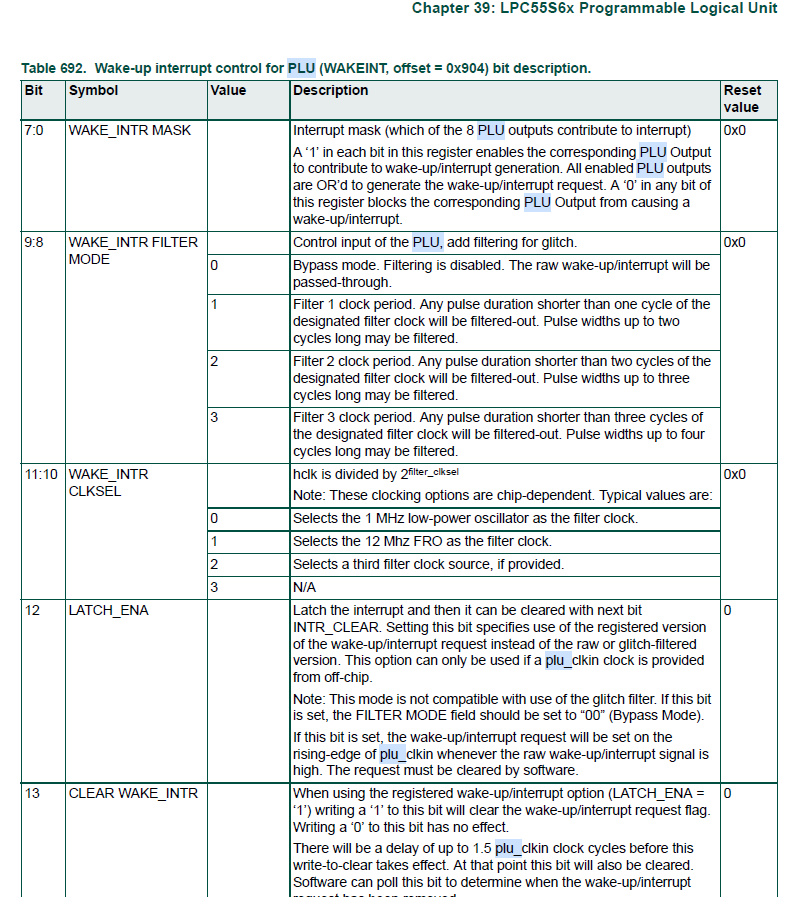

Pls refer to section 39.5.5 Wake-up/interrupt control register in UM11126.pdf, which is UM of LPC55S6x.
I copy it here:
"Any of the eight selected PLU outputs can be enabled to contribute to an asynchronous
wake-up or an interrupt request. All enabled output signals are logically OR’d together to
generate a single wake-up or /Interrupt request"
BTW, you have to write the WAKEINT register so that you can specify which PLU output signal triggers the interrupt.

Referring to the 38.5.5 Wake-up/interrupt control register from the UM, some glitching issues can occur when it comes to invoke interrupt using the PLU module due to the possible delay caused by the LUT network.
In a first trial, I left the default settings of the plu_wakeint_config_t, means no filtering is used and the clock cycle is default (using the PLU_GetDefaultWakeIntConfig). Then, the code get stuck in the PLU_IRQHandler and does not go out from the function.
As a trial to fix that, I thought that glitching may be the cause, so I updated the plu_wakeint_config_t in a way that it considers the filtering mode. Then, then interruption is no more invoked from the PLU module!

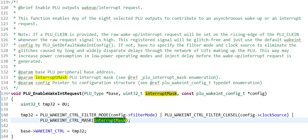

PLU_interruptMask= 11111111;
PLU_EnableWakeIntRequest(PLU, PLU_interruptMask, pPLU_interrupt_config); //Enables PLU outputs wakeup/interrupt request.
This is the definition of API:
I want what ever one of the 8 Outputs pin changes, then an interruption occurs.
