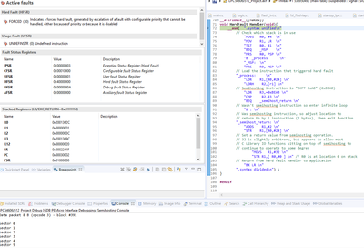

mpazzi
Hi Xiangjun,
this is the screenshot of error.
The error become at sector 5, simetime sector 4, I think depend where the code give error is placed in.
In previously project with LPC54608 I used FLASHIAP to update firmware through SD-card and it was fine, but in this project was not freertos.
I suppose that the reason of issue depend by Rtos, but I could not find the solution.
Any idea about that ?
Thanks for help
Best Regards
Marco

xiangjun_rong
Hi, Marco,
I agree with you, this is a Freertos issue. As you know when you are operating flash such as erasing or programming flash, any flash operation such as fetching code from flash or reading data from flash or interrupt will leads to hard fault. The Freertos is a multi thread operation, you have to disable all interrupt, suspend all task.
but currently, I have not idea to identify which code is executing except for the flash operation which is executed in internal RAM.
