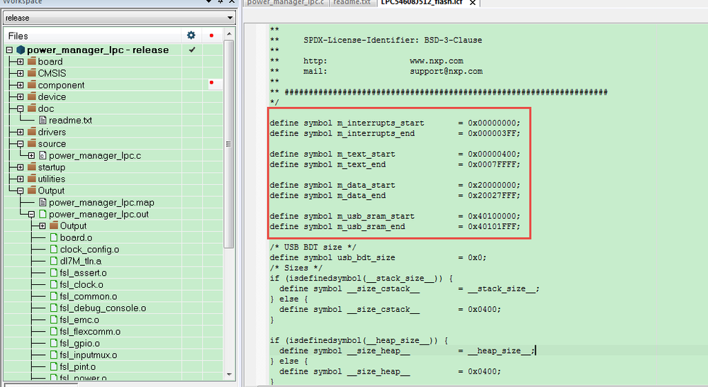

I've not encountered the similar phenomenon you mentioned, the testing condition is
1. SDK_2.5.0_LPCXpresso54608
2. OM13092 (LPCXpresso54608)
Fig 1 OM13092
Fig 2
TIC

1) Does OM13092 have an internal or external flash?
-- Yes, the LPC54608 has the internal flash and the power_manager runs in the internal flash.
Fig 1
