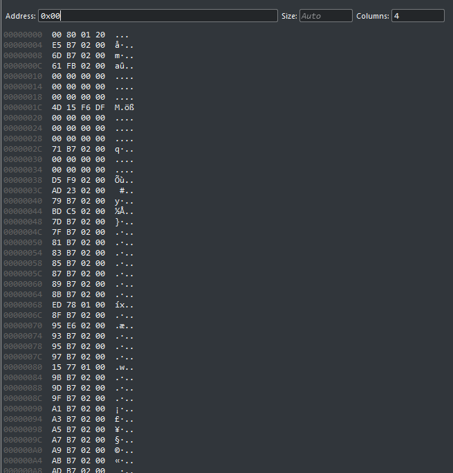

I am using the fsl_iap.h driver to write internal flash. I'm pretty much using the example code that comes with the SDK for the MCU. The problem is that the IAP calls are returning a success status code, but the task did nothing. It does not erase or write to flash. I'm using the memory viewer to what address 0x8000. It does not erase to all 0xFF and it does not write new data to it.
Below is the code.
Inputs to PTI_FLASH_BlockWrite are as follows in my test code that is not erase or writing.
Start = 0x8000
pSrc  = 0x200097ac which points to a 32kbyte RAM buffer.
Notes:
ECRP register is 0x00000000 and I have not touched OTP. MCU Core is running at 180MHz = systemCoreClock

This is on custom hardware. I am not running an example code, bud I did copy paste the above code from the lpcxpresso54608_iap_flash SDK example from SDK 2.7.0.
The MCUXpresso example works on the dev board OM13092 LPCXpresso54608. I can not run the MCUXpresso example on my hardware.
My code does not work on the OM13092 dev board either. So I think it may be a peripheral setting issue like a clock or IAP setting.
I am using SEGGER Embedded Studio. I put the example code in my project and nothing seems to write to flash.
Below is some simpler code to help debug the issue. I also attached a GIF of me stepping through the debugger. You can see the 0x8000 memory view and the local variables. You can see the status returned is 0x00 and the 0x8000 memory is never changes.
Below is an image of address 0x00 of my application binary. So you can see ECRP values.
    uint32_t systemCoreClock = CLOCK_GetCoreSysClkFreq();
    OS_INT_DisableAll();
    status_t status = IAP_PrepareSectorForWrite(1, 1);
    status = IAP_EraseSector(1, 1, systemCoreClock);
    status = IAP_CopyRamToFlash(0x8000, (uint32_t*)pSrc, 256, systemCoreClock);

guitardenver
I took your idea to confirm that the memory viewer does read 0xFF and you were right. Turns out the code was working fine, but the memory viewer is not updating for some reason. I read the flash region after erase into a RAM buffer and it all reads FF and after I program the flash it reads with the correct data.
It was an IDE issue.
