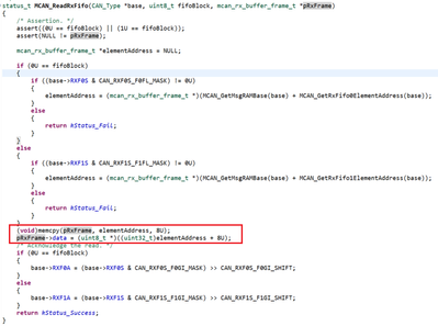

I'm using MCAN module in LPC54616 MCU in a very unstable environment, which causes assertion in MCAN_ReadRxFifo function when receiving null frames (rxFrame = NULL).
fsl_mcan.c
status_t MCAN_ReadRxFifo(CAN_Type *base, uint8_t fifoBlock, mcan_rx_buffer_frame_t *rxFrame)
/* Assertion. */
assert((0U == fifoBlock) || (1U == fifoBlock));
assert(NULL != rxFrame);
leading into MCU continiously stalling.
Is this a real assertion reason or could it be sorted out by skipping that reading?
Perhaps it's already been solved in later versions of SDK, can anyone confirm this? My SDK version is 2.10.
Thank you!

Harry_Zhang
Hi @Hector_Jimenez
Yes, you can add related code.
Or  you can add a new function.

2,590 Views
Harry_Zhang
Hi @Hector_Jimenez
In the MCAN_ReadRxFifo function,
assert(NULL != rxFrame)  is a necessary condition.
So it could not be sorted out by skipping that reading.
Harry

Hector_Jimenez
Hello @Harry_Zhang.
What if we ack the read and return failure? This return value could be checked when calling to MCAN_ReadRxFifo function and set a different status for CAN bus, like kStatus_MCAN_RxFifo0Lost.
    /* Assertion. */
    if (NULL == rxFrame) {
    	/* Acknowledge the read. */
        if (0U == fifoBlock)
            base->RXF0A = (base->RXF0S & CAN_RXF0S_F0GI_MASK) >> CAN_RXF0S_F0GI_SHIFT;
        else
            base->RXF1A = (base->RXF1S & CAN_RXF1S_F1GI_MASK) >> CAN_RXF1S_F1GI_SHIFT;
        return kStatus_Fail;
Kind regards

Hector_Jimenez
Hi, @Harry_Zhang .
We are testing the code I posted and it seems to work fine in these unstable conditions. Some frames are lost, but MCU doesn't get stalled.
Thanks for your help.
