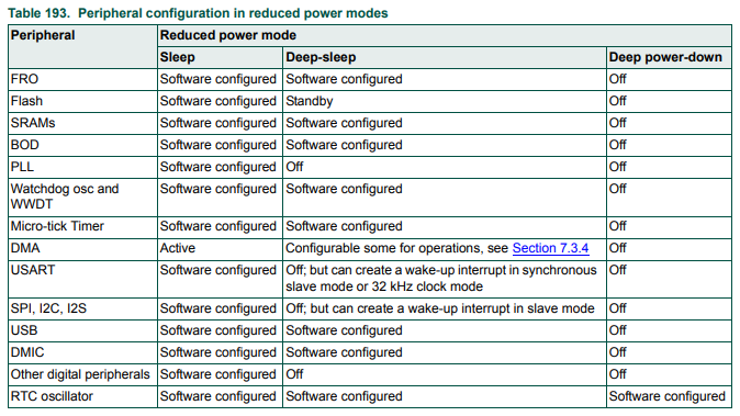

victorjimenez
Hello Dineshkumar J,
I recommend you to read chapter 7 of the user manual. In this chapter you will find all the information regarding the different Reduced power modes. In the following table you can see that in Deep power-down mode the only peripheral that you can leave on is the RTC. In the other hand, in Deep-Sleep you can configure almost all the peripherals to stay on.
I highly recommend you check the example "power_manager_lpc" provided in the SDK so you can have a more clear idea on how the reduced power modes work.
