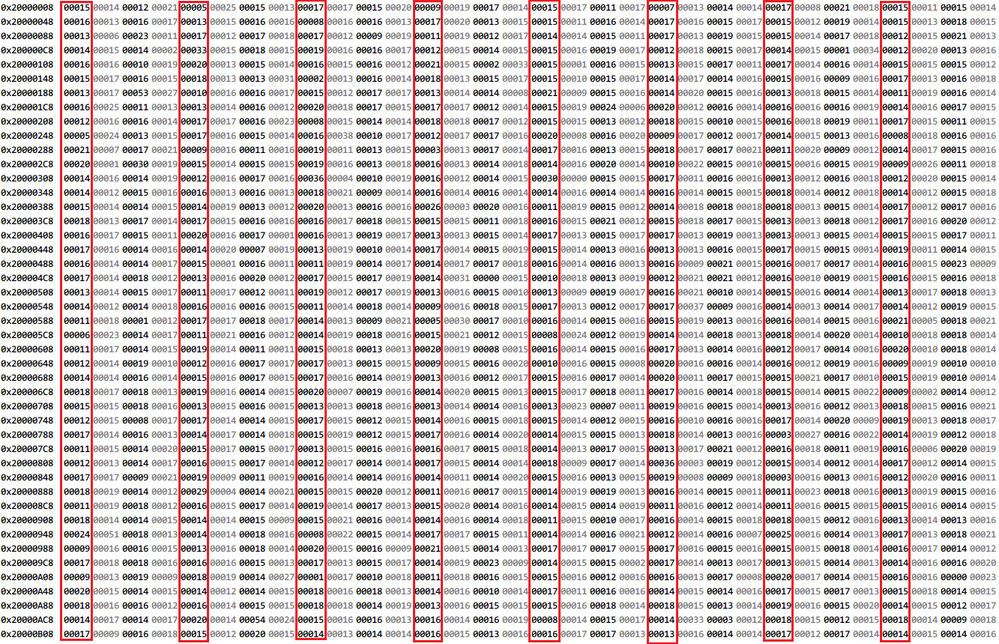

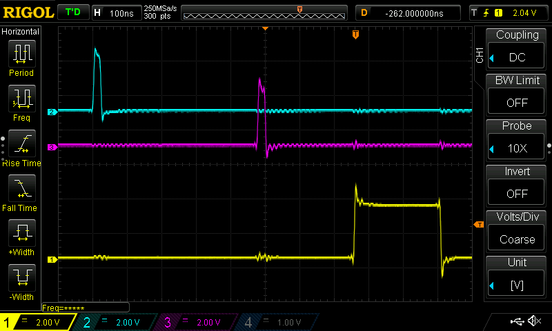

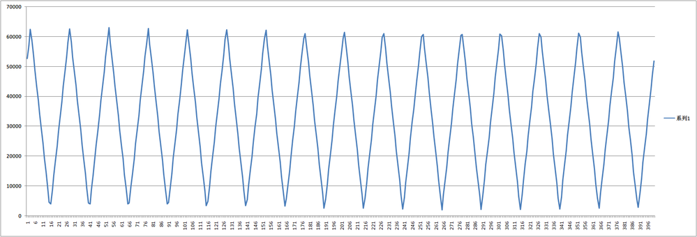

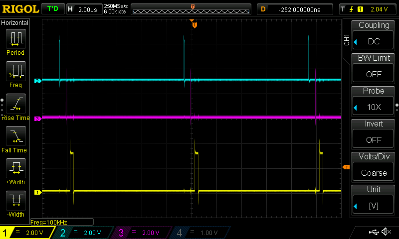

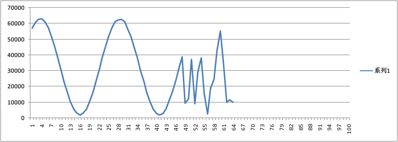

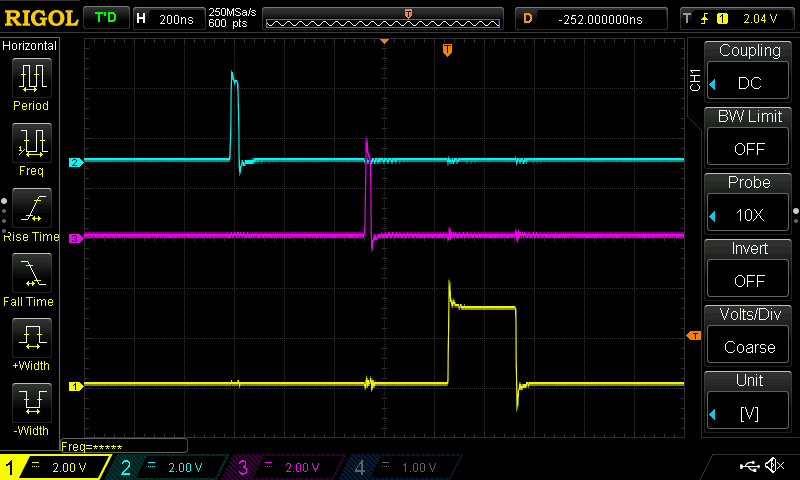

The 1st four transfers always work OK.   If I terminate the transfer at the 4th descriptor,  I can looked at the data and it is correct.     If I link the 4th descriptor back to the 1st,   data in my memory buffer is incorrect after the 1st four transfers.   It looks like it is ADC data BUT it is out of order.    I cannot find a pattern to the out of order data but it only appears to occur after the 1st set of 4 descriptors are executed.
Also note,  that the DMA is continually operating.  It is doing the correct number if transfers,  it just is not moving to the correct destination addresses.   It does appear the DMA is moving data into the correct region,  but the actual ordering is messed up.    I am monitoring via a pin on an o-scope when I get a DMA IRQ as well as when the ADC is triggered via the SCT.   I get ADC & DMA pulses at the correct rate, etc.

I used your method to export to excel, with my setup: 2 descriptors each transfer size is 4, 256 rollbacks(I re-configure destination in DMA ISR to make descriptor to increment to fill later buffer addresses, except for last rollback), I got almost perfect sampled data with waveform for more than 2000 samples, below is the waveform for first 400 samples (50 rollbacks):
I use triangle waveform to fill the ADC pin.
With your code indeed the data is corrupted, and later I found with my code the last iteration has corrupted data, now it seems to me if I didn't increment the destination of an descriptor when it is completed (i.e., next reload of this descriptor will overwrite the previous data), then the next time, this descriptor will get corrupted data.
Below graph has 3 iterations, the last iteration does not increment the descriptor target address so new data always overwrite old data in the next interation (rollback), and is corrupted.
If you set "DMA_LOOP_CNT" macro of my code to 1 then it is exactly like what happend in your code.

Today I took several hours to try to reproduce your issue, but I didn't reproduce.
In the attached code (You just replace with your M4.c), I set
#define NUM_BUFFERS                     2
#define DMA_TRANSFER_SIZE        4
#define DMA_LOOP_CNT                  256
I modified the code to make the descriptors fill larger range of memory: After the descriptor is completed, in DMA IRQ, I update its target address to increment by "NUM_BUFFERS * DMA_TRANSFER_SIZE * sizeof(CapturedData[0])", and I define "DMA_LOOP_CNT" macro to specify how many loops of the linked descriptors.
I also set system clock to 48MHz by "Chip_Clock_SetSysClockDiv(2);", ADC trigger rate 48M/192= 250kHz.
By this way I collected 255 rounds of data, I didn't see data loss when DMA roll back to first descriptor,
I use triangle waveform to make it more linear so easy to observe.
Below is the differential values (I showed more than 1000 samples, that is more than 128 rollbacks) of the samples, divided by 64, i.e., abs(sample[x] - sample[x-1]) / 64, for better observation, I didn’t know how you exported the data to excel, so I just take a screen shot and mark.
I use red blocks to highlight the first word of a descriptor, I didn't see abnormal large differential values in red blocks.
32,842件の閲覧回数

rocky_song
Hi Eli,
If I set the trigger edge to “DMA_CFG_TRIGPOL_LOW” then I can’t trigger DMA.
The one thing I observed is: In the linked ring descriptor usage, If a descriptor is reloaded by DMA w/o its destination address get updated, then ADC data sampled by this descriptor, which overwrites the old data, is corrupted.
However, if a descriptor’s data is overwritten by other descriptor(s), then data looks fine.
So in practice, user need to avoid data get overwritten by DMA, I think this shall be almost (if not all) the use case.

3.)   I set up some debug pins and have some scope plots:
I set the DMA Transfer size to 2.   This made seing the signals a bit easier.
YELLOW :     This gets toggled in the DMA transfer complete ISR
BLUE :           This is the output of SCT0_7,  the ADC start signal
PURPLE:       I enabled the ADC conversion complete routine.  The signal is toggled in the IRQ routine.
Plot 1:
I zoomed out so you could see the signals.    You can see everything looks
Plot 2
I zoomed in to see the timings around the conversion start,   the ADC complete and the DMA complete routines.

This is the Same as Plot 1 EXCEPT that the DMA transfer is only 1 ADC sample.
Plot 4:
This is Plot 3, just zoomed in around 1 set of pulses.

All of the plots make sense to me.    The ADC triggers,   it completes and then every 2 samples we get a DMA IRQ.
Let me know if there is anything else to try....  This very mysterious.
