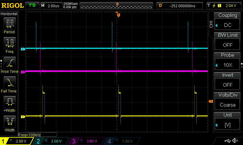

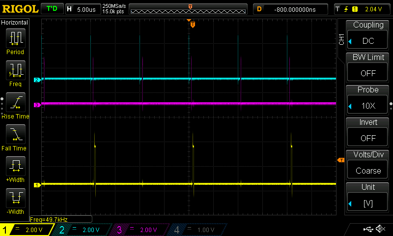

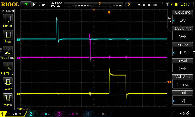

I am having a difficult problem with the DMA engine in the LPC54114.     I am trying to use the DMA in a continuously linked transfer described on page 160 of User Manual 1.4 UM10914.       Instead of a ping pong,  I am setting up 4 descriptors where the last one links back to the 1st.   I am transferring data from the ADC into some memory buffers.   To test,  I am feeding the ADC with a known frequency sine wave.
Observed Issue:
The 1st four transfers always work OK.   If I terminate the transfer at the 4th descriptor,  I can looked at the data and it is correct.     If I link the 4th descriptor back to the 1st,   data in my memory buffer is incorrect after the 1st four transfers.   It looks like it is ADC data BUT it is out of order.    I cannot find a pattern to the out of order data but it only appears to occur after the 1st set of 4 descriptors are executed.
Also note,  that the DMA is continually operating.  It is doing the correct number if transfers,  it just is not moving to the correct destination addresses.   It does appear the DMA is moving data into the correct region,  but the actual ordering is messed up.    I am monitoring via a pin on an o-scope when I get a DMA IRQ as well as when the ADC is triggered via the SCT.   I get ADC & DMA pulses at the correct rate, etc.

3.)   I set up some debug pins and have some scope plots:
I set the DMA Transfer size to 2.   This made seing the signals a bit easier.
YELLOW :     This gets toggled in the DMA transfer complete ISR
BLUE :           This is the output of SCT0_7,  the ADC start signal
PURPLE:       I enabled the ADC conversion complete routine.  The signal is toggled in the IRQ routine.
Plot 1:
I zoomed out so you could see the signals.    You can see everything looks
Plot 2
I zoomed in to see the timings around the conversion start,   the ADC complete and the DMA complete routines.
Plot 3
This is the Same as Plot 1 EXCEPT that the DMA transfer is only 1 ADC sample.
Plot 4:
This is Plot 3, just zoomed in around 1 set of pulses.
All of the plots make sense to me.    The ADC triggers,   it completes and then every 2 samples we get a DMA IRQ.
Let me know if there is anything else to try....  This very mysterious.
