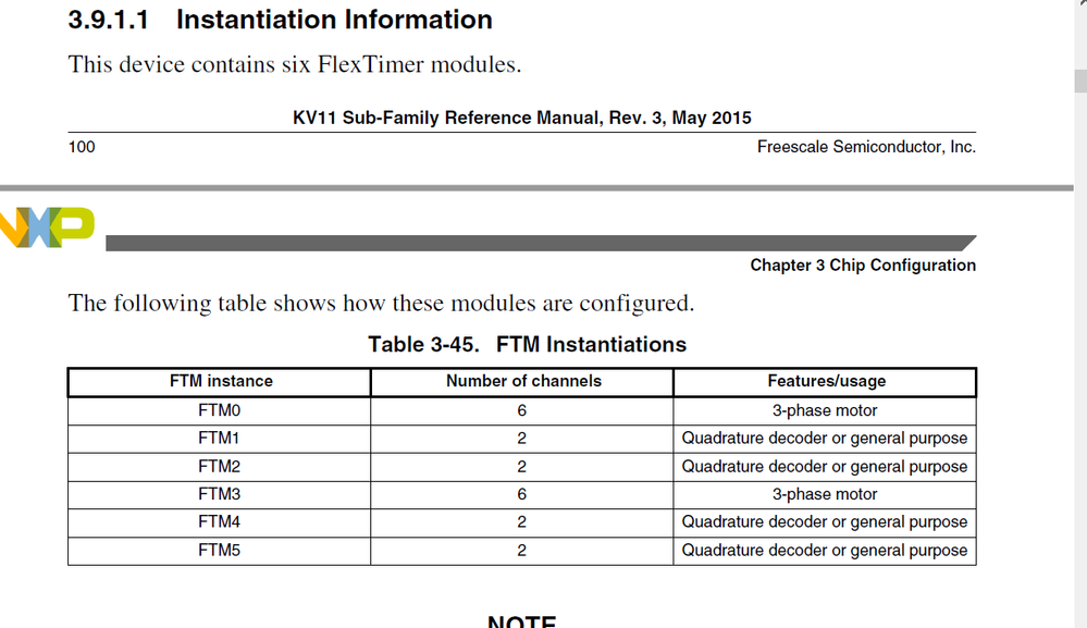

Frankly speaking, I do not think that the CTimer of LPC541xx can run in quadrature mode. Generally, the Encoder can generate PhsaeA and PhaseB signals in incremental mode, the PhaseA/PhaseB signals are phase shifting with 90 degree, the counter should count both rising/falling edges of both PhaseA and PhaseB signals, of course, the LPC5410x Standard counter/timers do not support the quadrature mode.
I suggest you use for example Kinetis KV family for example KV11.
