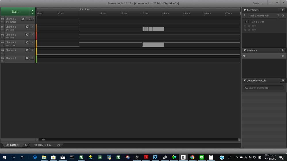

I download these two example file from https://mcuxpresso.nxp.com/en/example-projects?uvid=187339 :
spi_half_duplex_polling_master
spi_polling_b2b_transfer_master
but in both project, the SSEL port seems to keep high, even in transmiting data period.  I didn't connect the slave.
my initial setting are : (not changed)

sorry,  I found the problem.
cause I initial SSEL0 for config->sselNum
so according to AN12127, the pin assigned to SDA port. not the SSEL pin on board.
