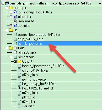

Hello Ping,
Thank you for the indications.
I have built and executed the periph_pllfract application on my LPCxpresso board and it works fine.
I have traced the code and I found out that  Chip_POWER_SetVoltage() is called.
I did not manage to find the source code of this routine.
My question: where can I find the source code of Chip_POWER_SetVoltage() ?
Thank  you
Michel
3,380件の閲覧回数
jeremyzhou
Hi Michel Kuenemann,
Thanks for your reply.
The Chip_POWER_SetVoltage() is called via iar_lib_power.a which locates in ~LPC Boards\lpc5410x_xpresso54102_keil_iar_v3.03.000_16\lpc5410x\chip_5410x\libs.
And the original codes of the library file seems like to be not publicly.
Ping
