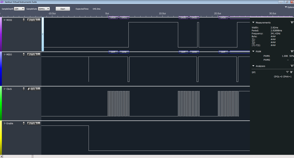

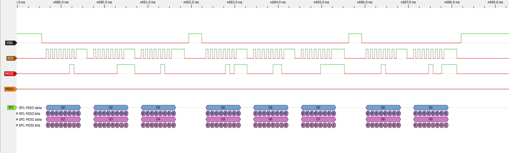

While testing the SPI clock modes I measured the following graphs with my logic analyzer:
SPI clock mode 0:
SPI clock mode 1:
SPI clock mode 2:
SPI clock mode 3:
My SPI settings:
Master Mode
MSB first
Data Length: 8 Bit
I used no high level functions to start the transfer.

In my opinion the SPI clock Mode 1 and 3 are correct working.
However the Mode 0 and 2 are not working correct.
In Mode 0 the clock should stay low in idle state and in Mode 2 it should stay high.
User manual UM10850 (LPC54102)
I set the slave select (chip select) by my selfe. I didn't want to use the slave select automatic.
Did I configure something wrong?

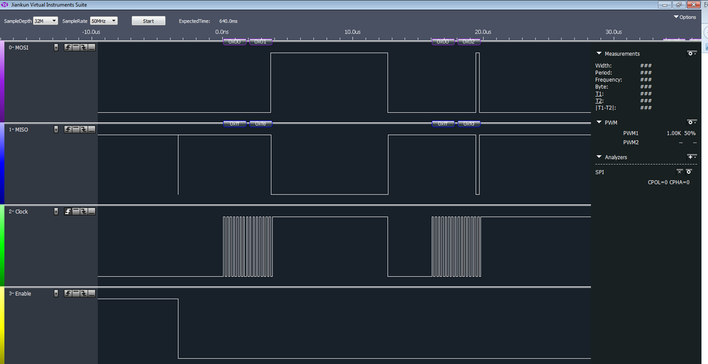

simonwyss
Thank you for your reply.
The SPI clock modes seem to work as expected. My posted pictures of the signals are correct.
Misleading was, that in clock mode 0 the clock stays high before the next byte starts. This happens due to "data stalls". The clock goes only low, if the next byte is ready to be transmitted.
I coded a minimal example without the use of the high-level callbacks for SPI data transfer.
Description of the SPI module of this microcontroller:
If the SSEL Assert is enabled, the SSEL is pulled active (low) if a data byte is written out on SPI. Additional bytes can be written the same way.
- If you know the when the last byte is sent, you can set the "end of transfer" bit (EOT in the TXCTL register). Then the SSEL is deactivated (high) after the transmission of the last byte.
-If you don't know when the last byte is sent, you can later force the SSEL to be pulled low by setting the "END TRANSFER" bit (END TRANSFER in STAT register).
If you force the "END TRANSFER" you have to wait until the SSEL is deassert (watch on "slave select deassert" bit in STAT register).
Result of the example:

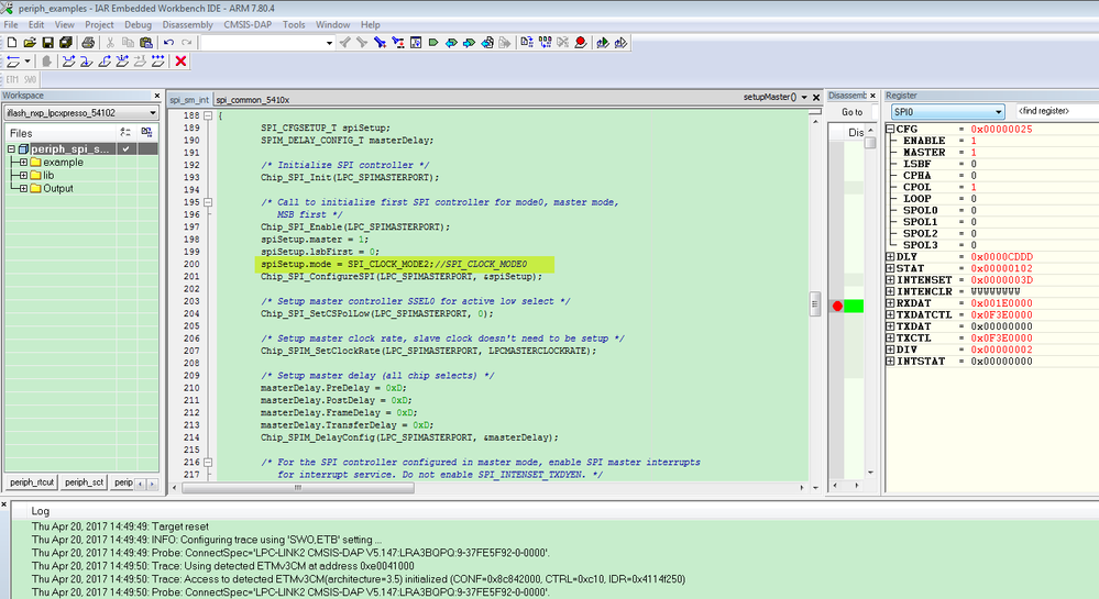

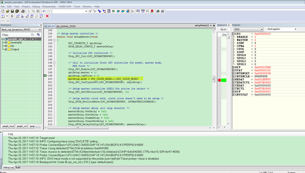

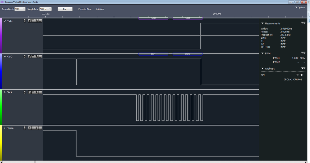

kerryzhou
Hi Simon Wyss,
   What the code you are testing?
 I have test this code:lpc5410x_xpresso54102_keil_iar_v3.03.000_16\lpc5410x\prj_xpresso54102\iar\periph_spi_int
Download link:
http://www.nxp.com/assets/downloads/data/en/software/lpc5410x_xpresso54102_keil_iar_v3.03.000_16.zip
board is lpcxpresso lpc54102

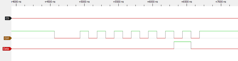

1. mode 0:
2.mode 1
3.mode 2:

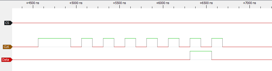

wave:
4. mode 3
Compare with user manual:
It totally meets the demand.
You can test the same project as me on your side again.
Wish it helps you!
Kerry

static void setupSPIMaster(void)
     SPI_CFGSETUP_T spiSetup;
     //SPIM_DELAY_CONFIG_T masterDelay;
     /* Initialize SPI controller */
     Chip_SPI_Init(LPC_SPIMASTERPORT);
     /* Call to initialize first SPI controller for mode0, master mode,
        MSB first */
     Chip_SPI_Enable(LPC_SPIMASTERPORT);
     spiSetup.master = 1;
     spiSetup.lsbFirst = 0; //0=MSB first
     spiSetup.mode = SPI_CLOCK_MODE0;
     Chip_SPI_ConfigureSPI(LPC_SPIMASTERPORT, &spiSetup);
