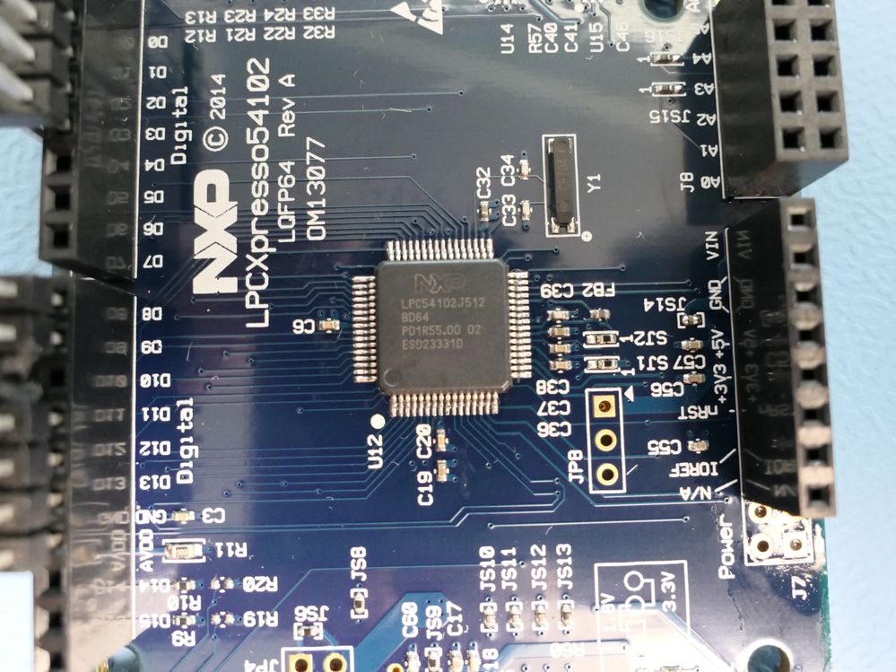

Pablo_Ramos
Hi @grosdode
We are investigating your problem, but we would need more information about the marking code of the chip, please send us a photo of the chip.
Thanks.
27,372件の閲覧回数
grosdode
Picture is attached
27,343件の閲覧回数

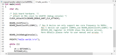

Pablo_Ramos
Hi again @grosdode ,
I noticed that there is a typo in the LPC541xx documentation. An apology for the inconvenience.
There is an errata about the maximum operating system clock in ES_LPC5410X, where is stated that the maximum operating system clock on the LPC5410x device (rev 1B) is limited to 96 MHz.
Errata sheet LPC5410x (nxp.com)
An also in SDK examples (for example hello world) there is also a note that apply for the rev 1C (which you have) where is mentioned that rev 1C is limited to 100Mz.
So please operate your application under these limits.
Hope it helps you!

Pablo_Ramos
Hi, @grosdode
An apology for the confusion I notice that there is a new version where this issue is fixed. Rev C can run PLL up to 150MHz.
Please use the SDK version 2.6.1, there is a new function that let you to init the PLL to 150MHz, also it solves the note (or SW errata) about the Rev C, you just need to change the function BOARD_InitBootClocks(); to now use BOARD_BootClockPLL150M();
This should work also for Rev D.
Rev B is still limited to 96MHz
Hope it helps you.
