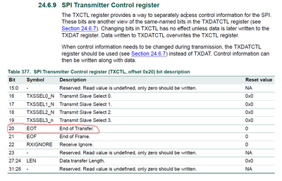

xiangjun_rong
From hardware perspective, if you set the EOT bit in the spi TXCTL or TXDATCTL register, the TX_sselx pin will be asserted for each transfer.
in the driver, I suppose it is okay:

JBM
Contributor V
I already have that set.  The way I read the documentation that causes the chip select to be deasserted at the end of the transfer and that is what it appears to do.
I need the chip select deasserted for each frame (16 bits) as shown in the figure I quoted.
I have the SPI working by doing a transfer for each frame but that takes about 5ms to read the data from the sensors. That's about a 1000 times longer than doing it in a single transfer which is what I need to do.
