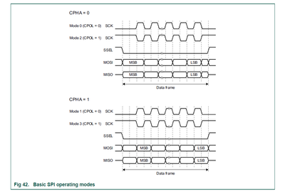

Sorry but I'm not understood your second part of replay about CPHA and CPOL.
I know this settings are about clock phase and clock polarity over the SPI interface, are they related also to the CS signal behavior? I think the CS is cleared at the start of SPI transfer and released at the end of transfer independently of CPHA and CPOL configuration do you agree?

Yes, the CPOL/CPHA setting is not related to the /CS signal.
For the CPOL/CPHA setting, the CPOL only controls the polarity of the SCK clock. For the CPHA bit, when the CPHA is 0, the first edge of SCK latches the data, When the CPHA is 1, the second edge of SCK latches the data pin.
I copy it from the section 22.7.1 Operating modes: clock and phase selection from UM10850.pdf.
