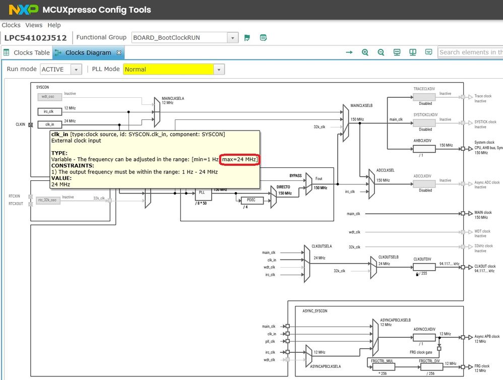

kennethkong852
Hi Alice,
Thank you for the reply and information there!
When I use the Clocks Config Tool (accessed from SDK Builder), I noticed that for the Configurator would not allow me to type in 25 MHz for CLKIN input.  It's limited to 24 MHz.
Please see attached photo for reference.
CLKIN valuesCLKIN values
BR,
Kenneth
タグ(2)
1,956件の閲覧回数
Hello @kennethkong852
Thanks for your report.
This is a bug in the Clocks Config Tool. The issue arises because the new version of DS has changed the frequency from 24M to 25M. In old version DS, still 24MHZ.
I will report this bug to the Config Tool development team promptly.
For now, if you need to use 25MHZ, please configure it via code.
I apologize for the inconvenience this has caused you.
Alice
