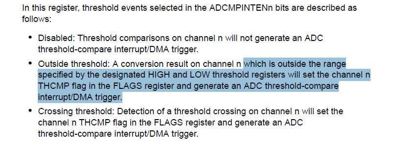

First I want to start by apologizing that I'm a newbie. I'm still learning from example codes and all that stuff. I have already watched all the ADC-related articles on the forum but there don't seem to have anyone having this problem. So, I'm trying to use ADC combined with SCTimer. The idea is that the SCTimer will generate a 100% duty cycle PWM while ADC reading the value. Once the ADC value reached the high threshold (I didn't set the low threshold), it will trigger threshold interrupt in which I set the SCTimer to change the duty cycle to 30%.
After multiple test runs, the ADC could successfully read the value, and I could see from the console that the "Threshold Range" shift from 0x0 to 0x2, which means the value is higher than the high threshold. The PWM, however, still stayed the same at 100% duty cycle, and there was no ADC threshold event shown on the console as well.
I then used ADC example to test the threshold interrupt, adding simple LED toggle in the threshold interrupt handler as below. The outcome was always the same. The LED didn't react, and there was no ADC threshold event shown on the console though the threshold range showed that the value already passed the threshold.

Hello curryhuang3627,
After I checked your question and code, I think you need configure threshold comparison interrupt to
outside threshold, not crossing threshold:

Thanks for the quick reply.
I think "outside threshold" might be the solution to my problem but I'm still having a hard time understanding the difference between the two. To me, I feel like they were saying the same thing.
How do you define "threshold crossing" and what do you expect to see if you configure this register?
sorry to bother you.
3,594 Views
Hello ,
In my opinion, "crossing threshold " option means when ADC data just equal to the threadold.

Thanks for the timely help.
I owe you a big one.
