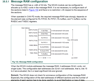

My issue comes when I try to use the CAN bus (MCAN driver), it seems the CAN message RAM is the source of the issue. When I add this line:
__attribute__((aligned(1U << CAN_MRBA_BA_SHIFT), section(".data"))) uint8_t msgRam[MSG_RAM_SIZE] = {1U};`
Here is my result, as you can see the m_data region sharp increases:

For your question, as you have seen the line:
The CAN_MRBA_BA_SHIFT is 16 bits, it means that the compiler has to allocate 64KB memory space with low 16 bits all 0x0000, for example the this is a valid address 0xXXXX_0000.
This is the message RAM part, all the Receiver Filter, message buffer, and receiver FIFO are all put in the message RAM,the start address is written in the  Message RAM base address register, pls refer to section 36.8.44 Message RAM base address register.
I have checked the CAN example with SDK with 2.7.0 version, it writes a memory address directly.
#define MSG_RAM_BASE 0x20010000U
/* Set Message RAM base address and clear to avoid BEU/BEC error. */
MCAN_SetMsgRAMBase(EXAMPLE_MCAN, MSG_RAM_BASE);
uint32_t *p = (uint32_t *)(MSG_RAM_BASE);
memset(p, 0, (8U + CAN_DATASIZE) * sizeof(uint8_t));
In order to save the memory address, you can refer to the method to write an immediate value to the
The assert() only verifies if the address is in the RAM address range.
